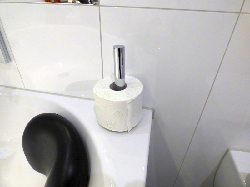

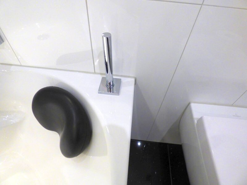

Showerhead works perfectly as a toilet paper holder, much to my wife's dismay When I saw just the picture, I was about to say that the paper roll would always be at risk of getting wet.
But since the "roll holder" is also your showerhead, that risk should be quite low.
