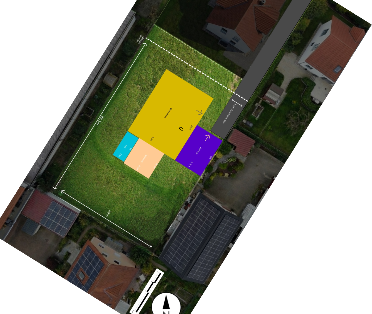

after reading along for a while, I would now like to ask for your assessment and ideas. We are still relatively early in the concrete planning phase and hope to get feedback on the overall implementation, the placement of the house, garage, etc., as well as on the sensible use of the plot.

Photos and a drawing of the plot are attached below.

* Where would you position the house reasonably on the plot?
* How would you arrange the garage (integrated vs. attached vs. detached)?
* How would you lay out the garden area with outdoor kitchen, pool, and terrace?

Plot from above
Own sketch
North-oriented drawing

Plot from above
Own sketch
Bauhelm5 schrieb:
No other images are available at the moment. The property is currently being resurveyed, and then the site development will be planned. I saw no reason not to orient the aerial photo north even without the prior resurvey, see attachment. By the way, I assume your garage door will need to maintain a 5m (16 ft) distance from the street.
