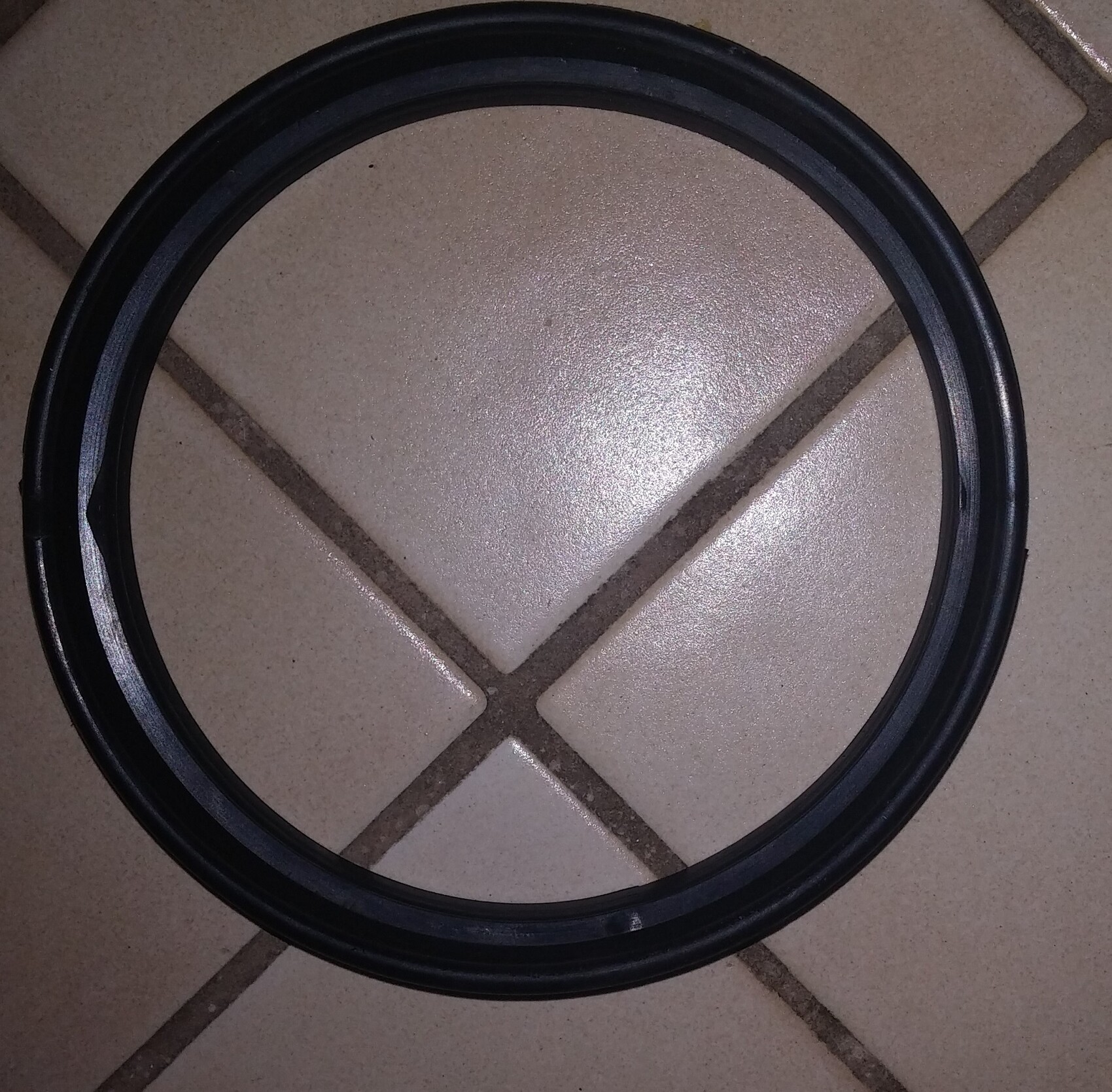

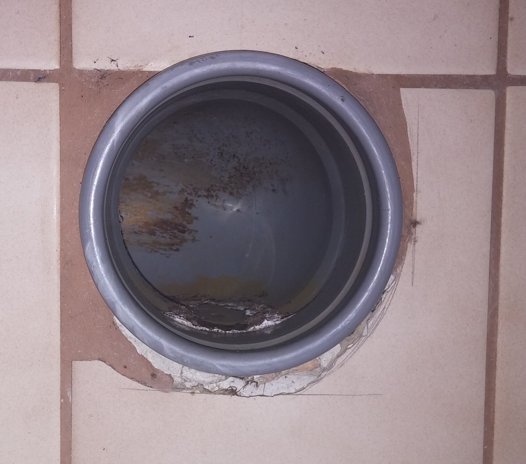

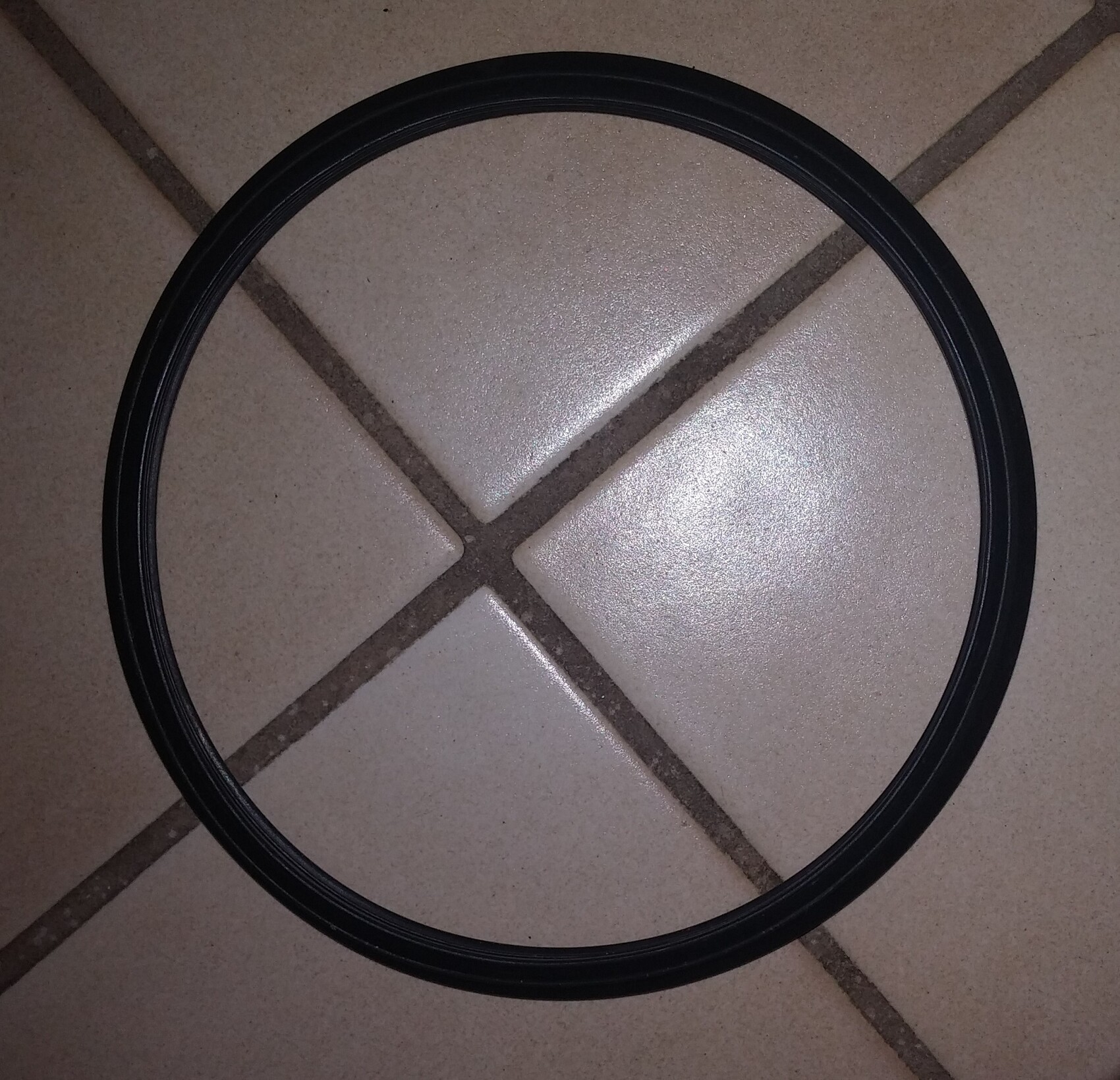

What is the best way to reinstall the seal on the toilet waste pipe inside the wall?
The pipe has a small collar at the front where the seal is supposed to slide back on, but I can’t get it back underneath. I’ve already tried heating the pipe with a heat gun, but it just won’t work.
Maybe you have some tips for me

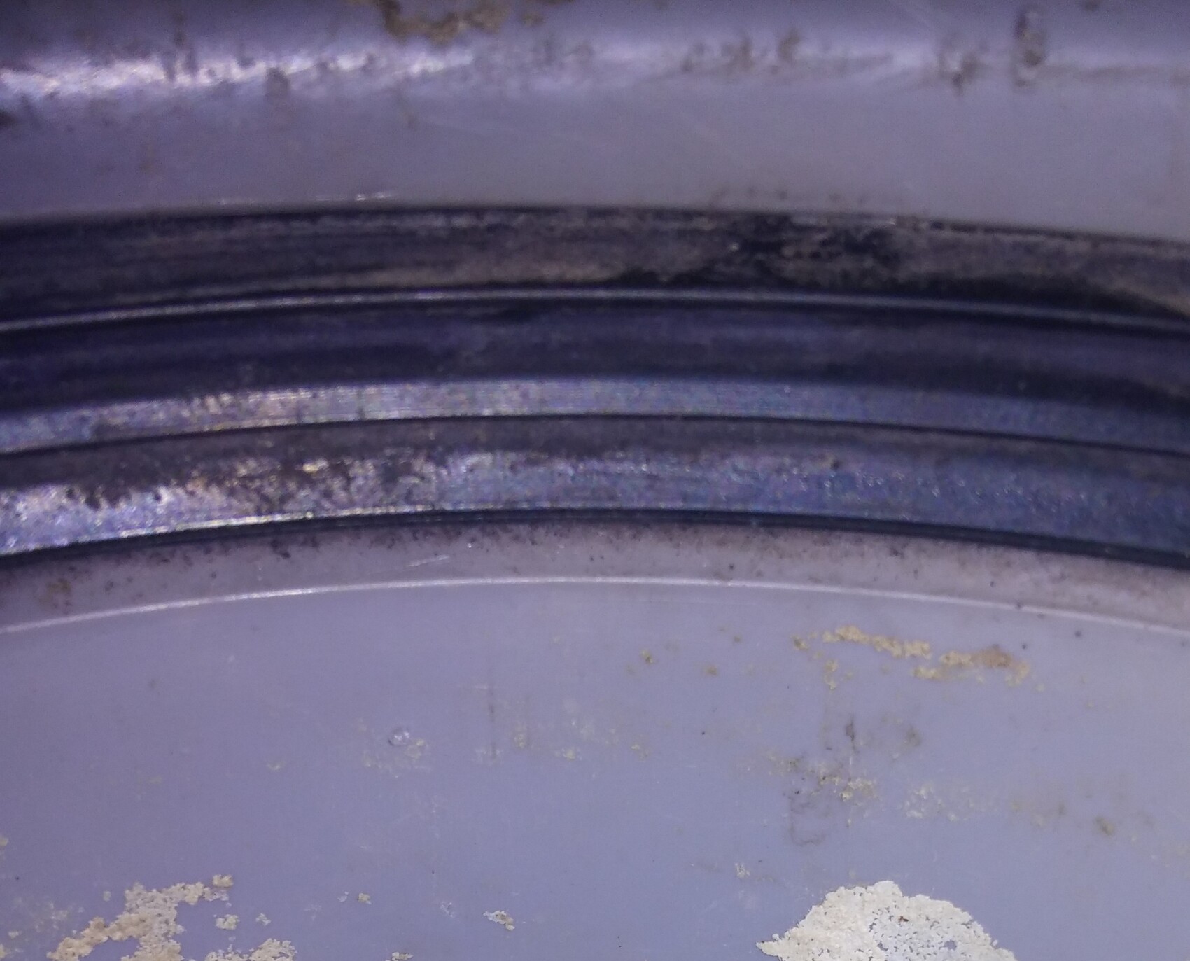

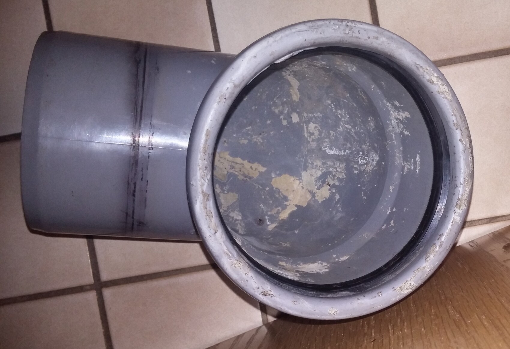

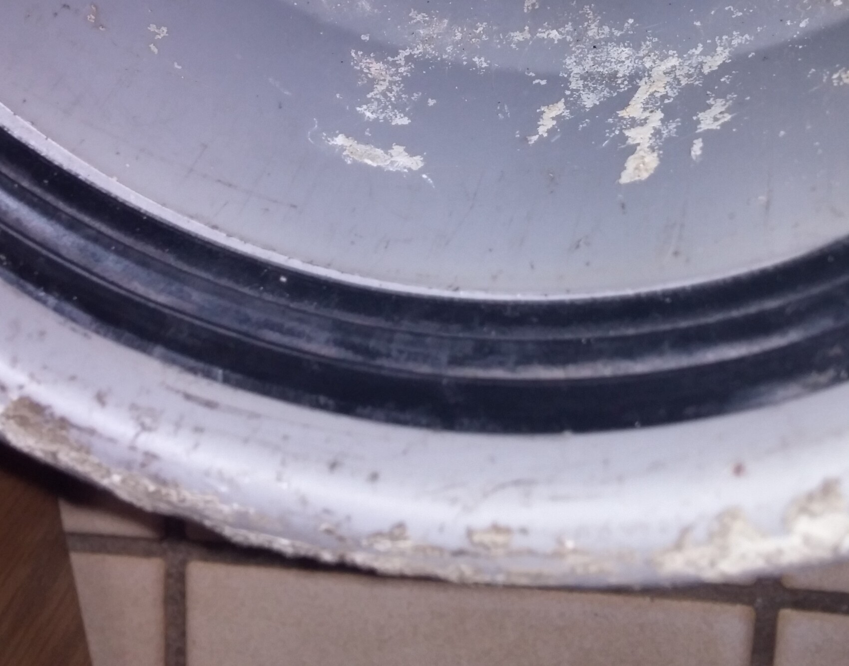

Here are a few pictures of an old arch where the seal is still in place.

wrobel31 Jul 2016 18:57
Hello Schwabe
The shown bend has a factory-installed lip seal that is normally not removable.
The new seal does not fit there.
You need to replace the entire bend.
Olli
