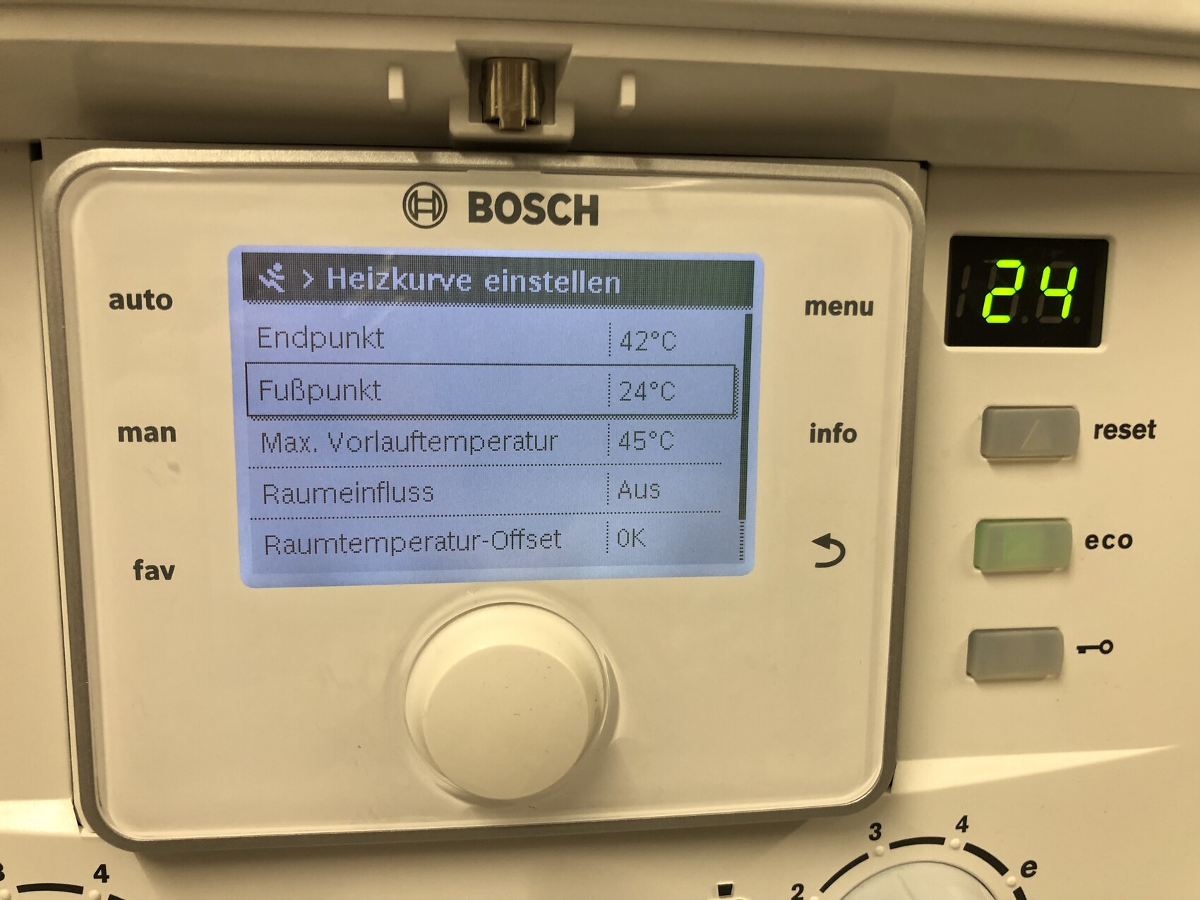

The button in the upper left corner is for Auto.
Mycraft5 Feb 2019 09:37
I just checked, for your controller it’s enough to remove the setback, then it will operate in automatic mode. The underfloor heating mode is disabled, so you’ll need to experiment with the footpoint/endpoint settings.

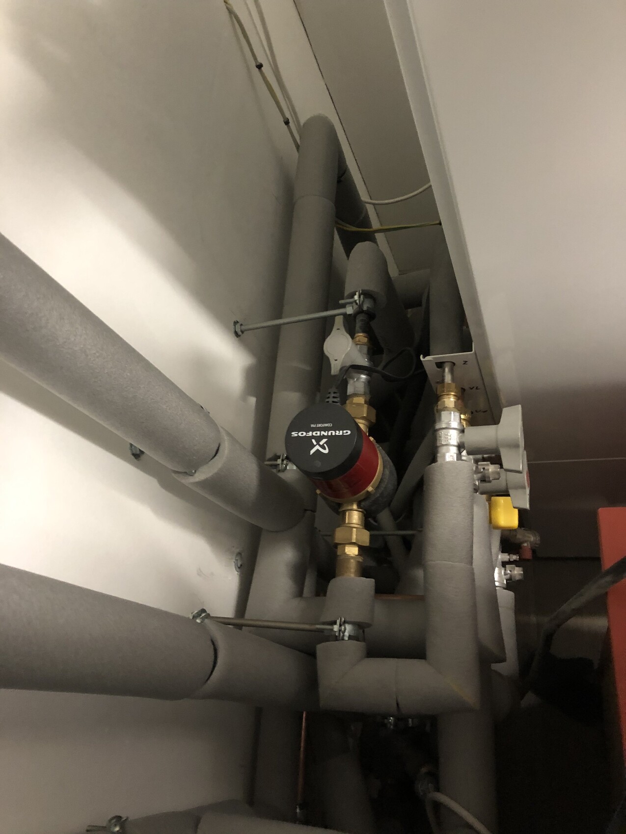

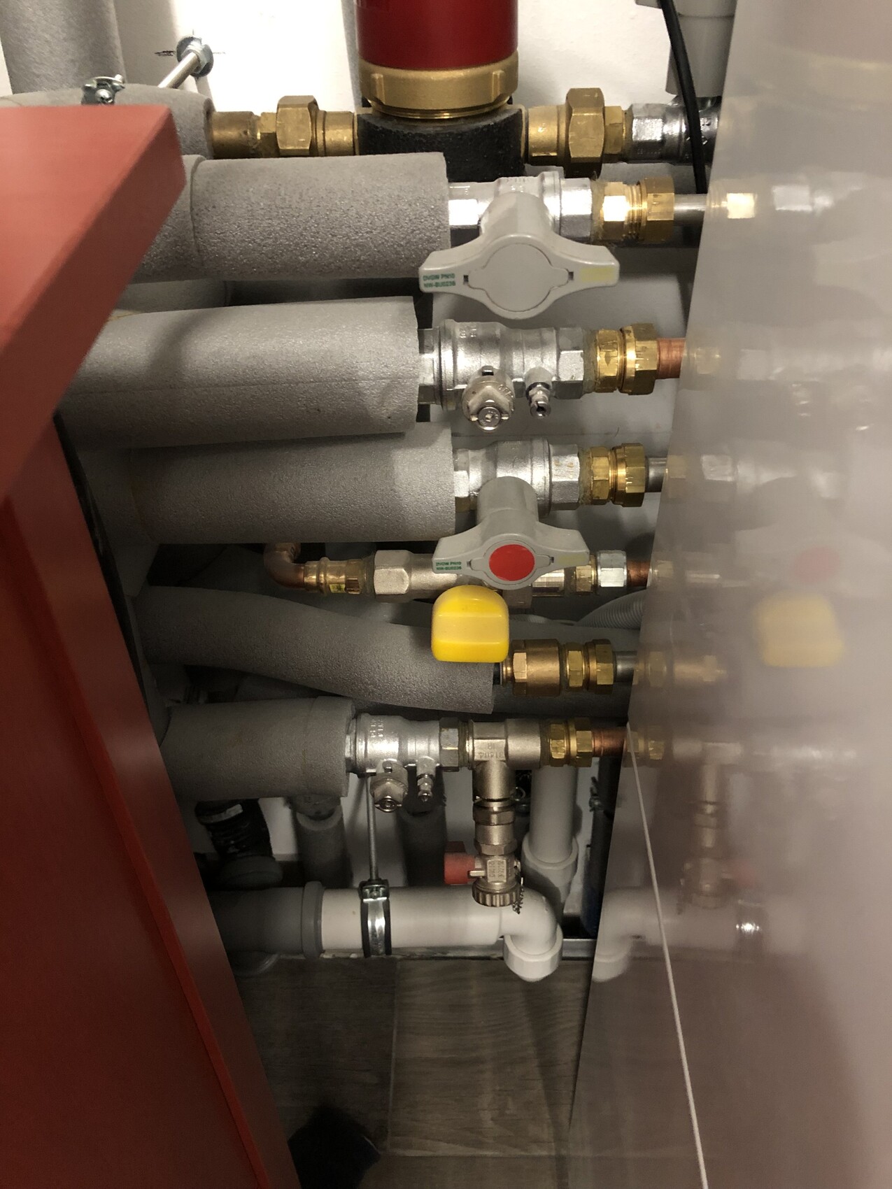

There should actually be thermometers on the supply and return pipes.
Goldi09111
7 Feb 2019 20:37
There are no thermometers on the pipes (see pictures).

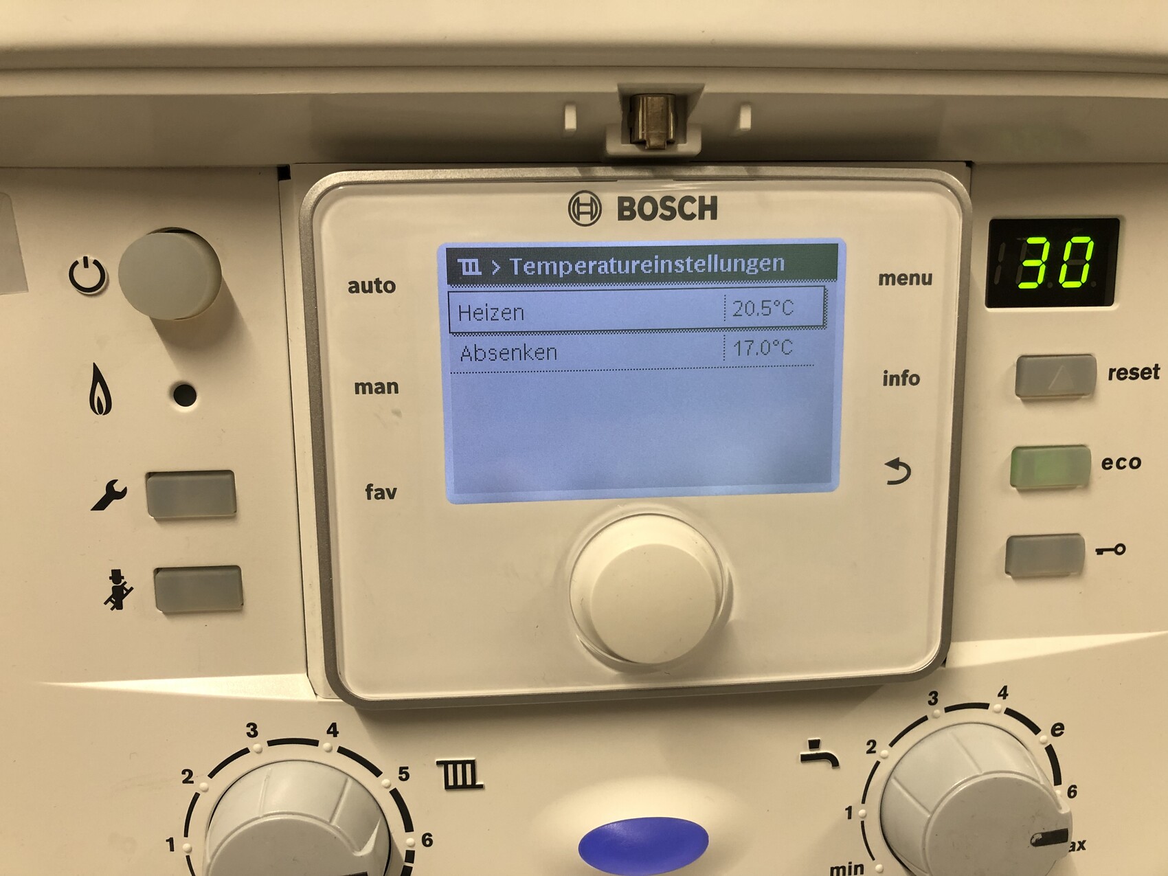

I adjusted the heating temperature from 19.5 to 20.5°C (67.1 to 68.9°F) and set the heating curve endpoint from 44 to 42°C (111.2 to 107.6°F) and the base point from 27 to 24°C (80.6 to 75.2°F).
Additionally, I set the heating times back to 4:00 AM – 8:00 PM. After switching to continuous operation on Monday evening, the heating cycles increased from about 100 per day to 200.

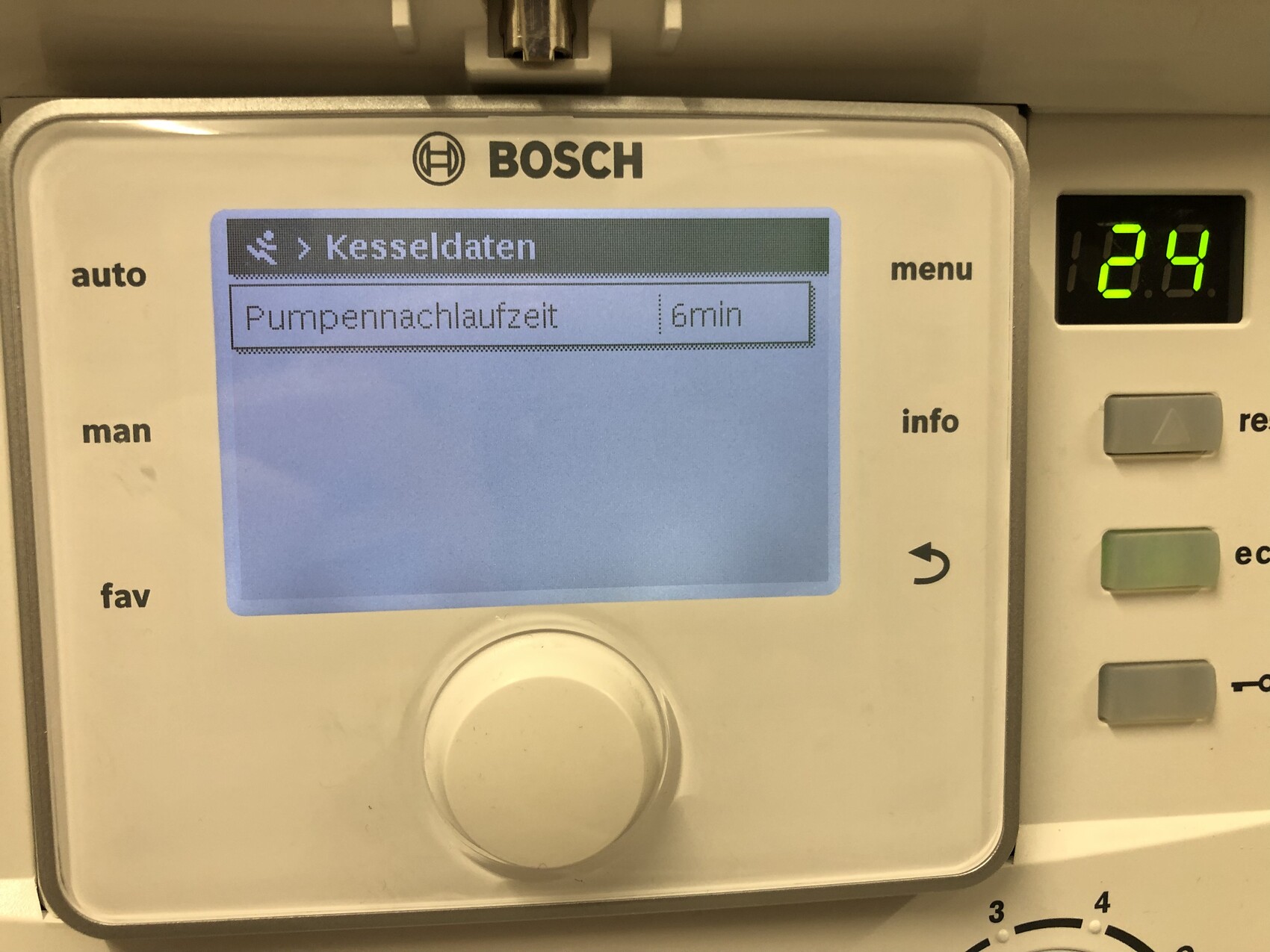

Is the last image with the pump post-run time of 6 minutes okay?
