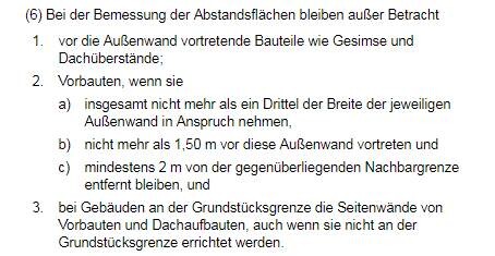

Without a specific project, just to clarify the matter…
According to the Saxon Building Code, the following applies to setback areas for projections:
Textseite zu Abstandsflächen im Baurecht mit Regeln zur Bemessung
In the scenario below, does the width of the projection on the right side refer to the wall length L or X?
