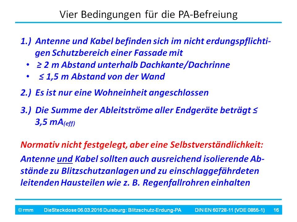

Facade antennas that are not mounted within the designated safe facade areas must be grounded like roof antennas with a lightning current-resistant conductor of at least 16 mm² (25 mm² (40 mils) copper, 50 mm² (100 mils) steel/zinc-coated) and connected to the equipotential bonding system.
According to the current DIN EN 60728-11 (VDE 0855-1):2011-06 standard, the previously mandatory equipotential bonding is now optional if the following conditions are met:
Starting from a Quatro LNB, the limit for leakage currents can already be exceeded. Therefore, without the ability to measure leakage currents, it is recommended to install equipotential bonding, typically using 4 mm² (12 AWG) copper conductor, even when antenna grounding is not mandatory.
Grounding and equipotential bonding are integral parts of the electrical system and installations must comply with NAV § 13. However, not every electrician licensed by a network operator for low-voltage installations is necessarily an antenna specialist or qualified regarding lightning current-resistant grounding and equipotential bonding.
