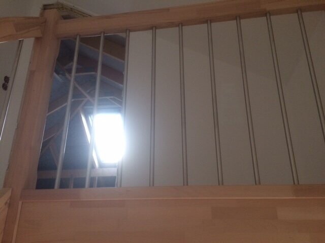

Nordlys
27 Oct 2017 12:31
Construction site interior work: Timber frame structure and metal wall
Double-glazed. Large. Like a woman.
