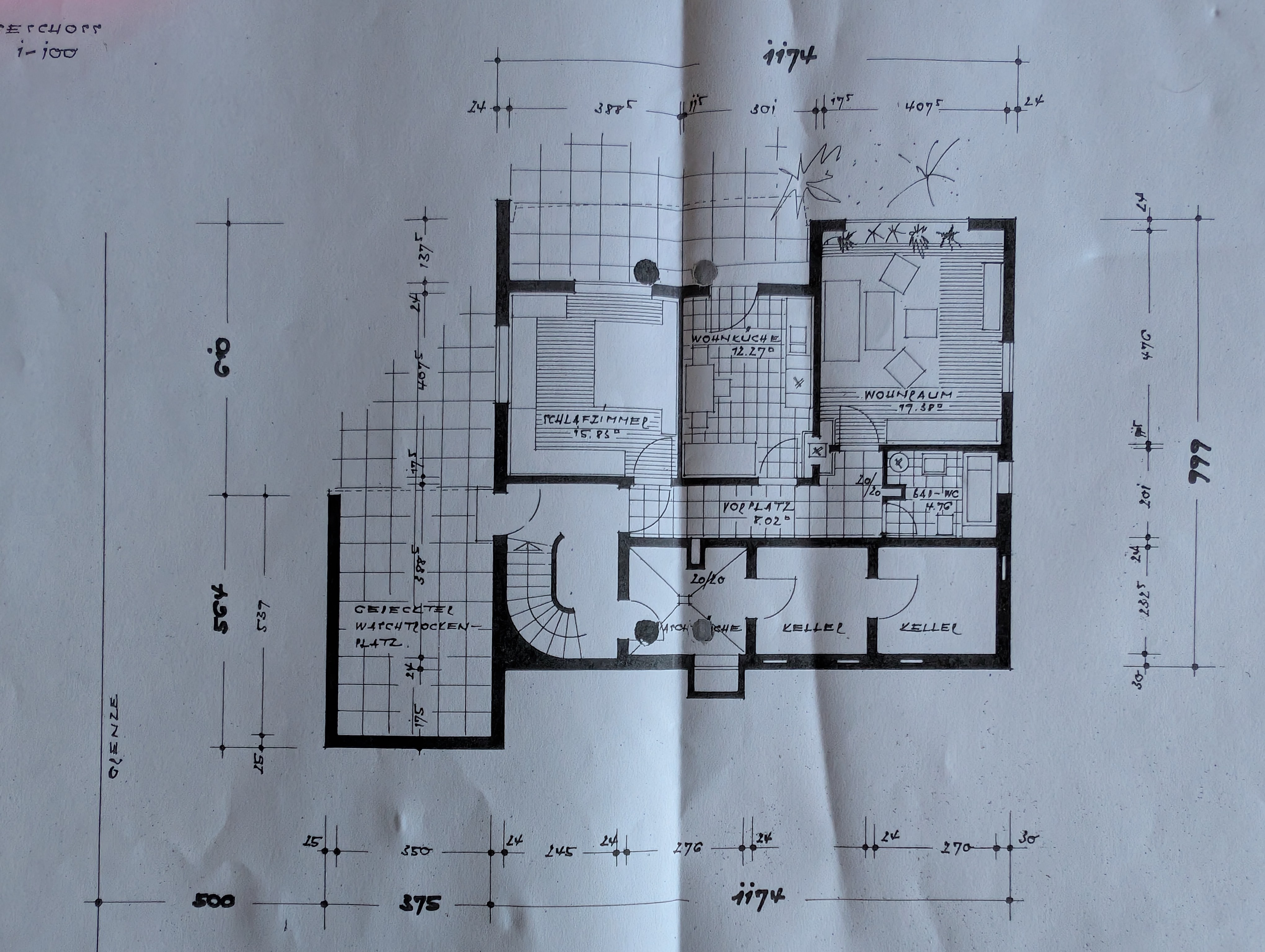

My wife and I have taken over my grandparents’ hillside house from 1961 and need to carry out a complete renovation (water, electrical, and heating systems are outdated). At the same time, we plan to convert the attic into a granny flat for renting within the family, and the two existing living units (2 rooms in the basement level and 4 rooms on the ground floor) are to be combined into one unit with an open kitchen and dining area on the basement level, with access to the garden. The ground floor will accommodate three bedrooms, a study, and a bathroom.
The house is nicely south-facing, offering an unobstructed view of the valley, which we want to enhance with larger windows on the south side.
The biggest challenge in the renovation is the staircase that separates the two living units; a second staircase will likely have to be built inside the apartment.
Due to the hillside location, there is limited basement space and overall probably not enough room for utility areas. We are considering giving up the study in favor of a utility room on the ground floor.
To create slightly more spacious rooms on the ground floor, we are thinking about replacing the balcony (which will probably hardly be used from the bedroom) with an extension.

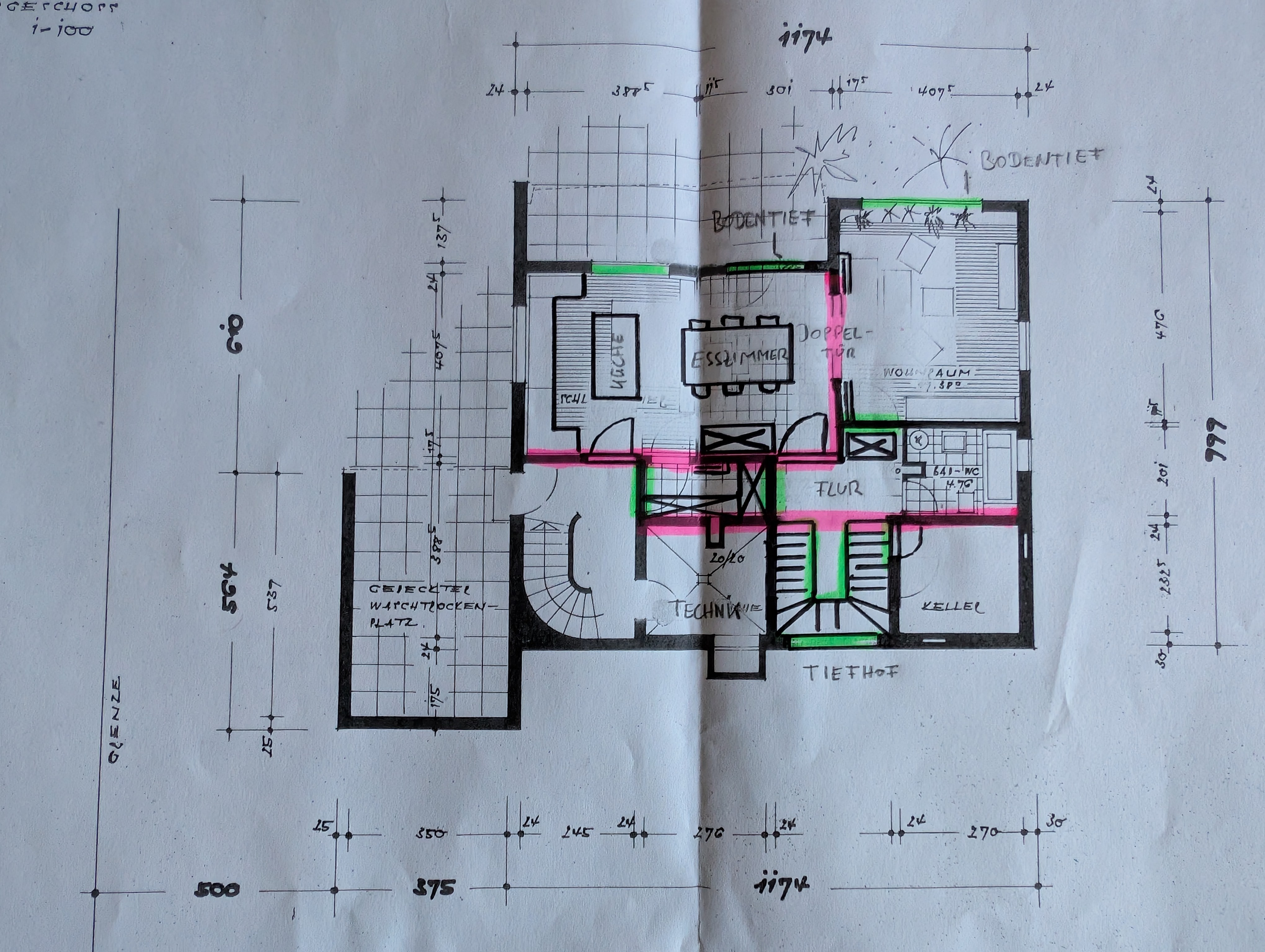

I have copied the original approved plans of the house and, as a layperson, roughly sketched how we imagine the renovation, including ideas from initial talks with architects. A structural engineer has not yet visited the site, but we have found plans for the hollow core slabs, so before the engineer’s assessment, we have a fairly good idea which walls are load-bearing (highlighted in pink).
We are already quite happy with our ideas and would like to have them developed professionally by an office now. But before that, I would like to invite criticism from the forum. What do you notice? Would you have other suggestions?
The granny flat in the attic will be left aside for now as there are no plans yet.

Ground floor plan
Attic plan
Ground floor plan with load-bearing walls in pink and modifications in green
Attic plan with modification ideas in green, load-bearing walls in pink
The inserted plans look a bit small… I might have to revise the post.
I am very much looking forward to your feedback! Best regards!
