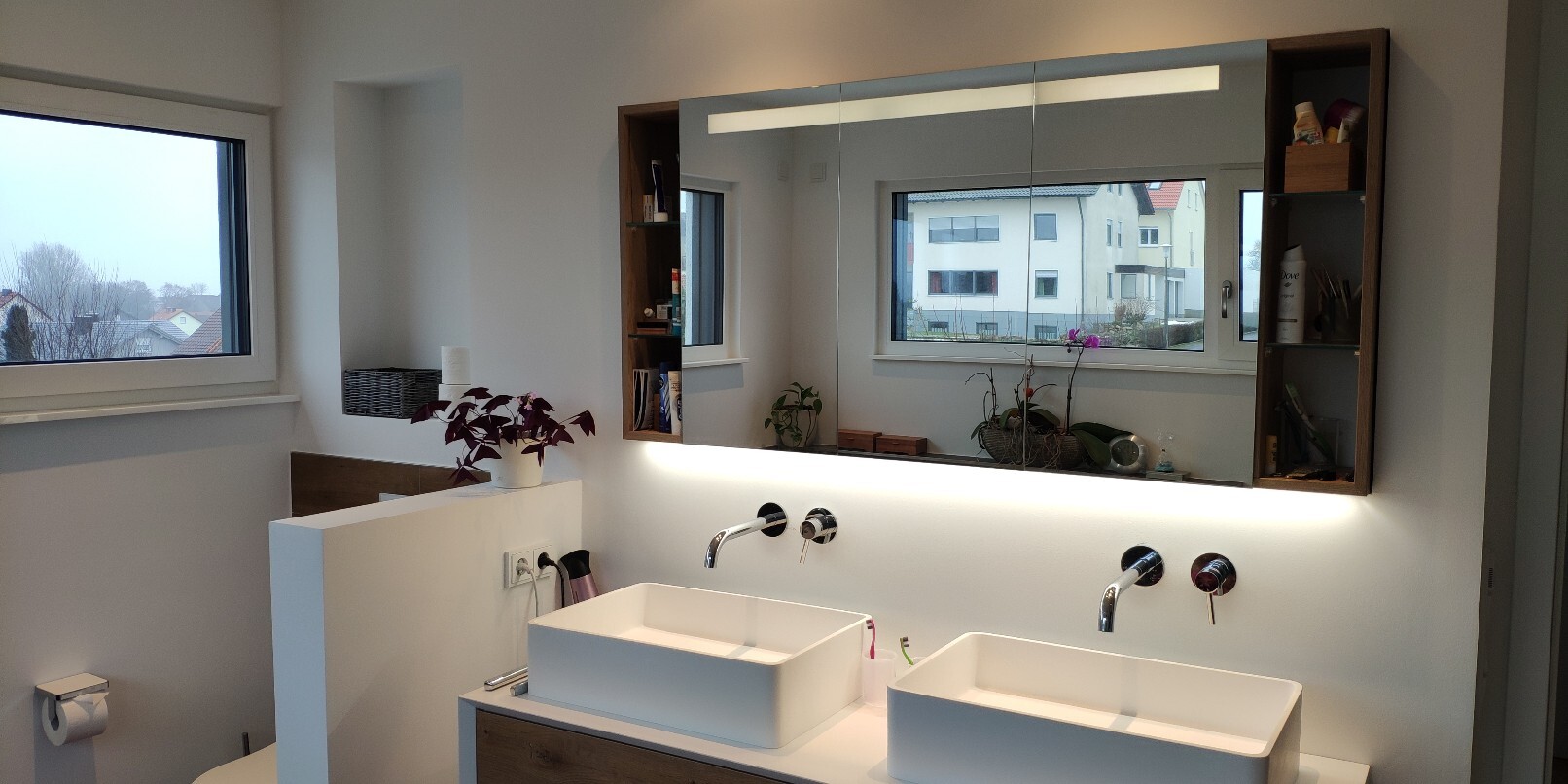

We have a timber frame construction and a recessed mirror cabinet. This was not a problem at all; during the planning phase, we simply included a wall niche with the desired dimensions and later installed the recessed mirror cabinet. No aluminum frame or anything like that was needed. We just left a shadow gap on all sides, which looks great and was completely hassle-free. Of course, you can also install a regular mirror cabinet in such a wall niche.
KingSong6 Jan 2019 11:55
Modern bathroom with double sink, illuminated mirror, shelves, and window view.
