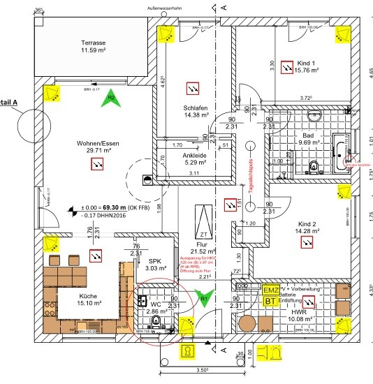

Hello forum,
I need your collective expertise. I understand that a smoke detector is required in every bedroom. However, I am unsure about the situation with an open-plan kitchen and living area, and where the smoke detector should ideally be placed in the hallway. I would appreciate any practical advice.
Floor plan of a house with living room, kitchen, hallway, bathroom, bedroom, and children’s room.

micric3 schrieb:
Hello forum,
I need to tap into your collective knowledge. I understand that a smoke detector is required in every bedroom. However, I’m unclear about the requirements for an open-plan kitchen and living area, and the ideal placement of a smoke detector in the hallway. I would appreciate any practical advice.
As an example, I’m sharing the layout provided by the security company working with us. They will be installing the smoke detectors and motion sensors. Maybe this will help you.
Floor plan of a house with terrace, living room, kitchen, bedroom, 2 children’s rooms, bathroom, hallway
