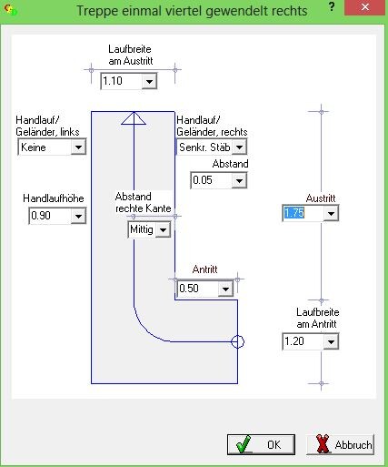

The staircase seems adequate, but it looks quite steep. What are the measurements there?

I’m not quite sure about the staircase situation. I’ve attached a screenshot of the settings. Do you think this is too narrow?
