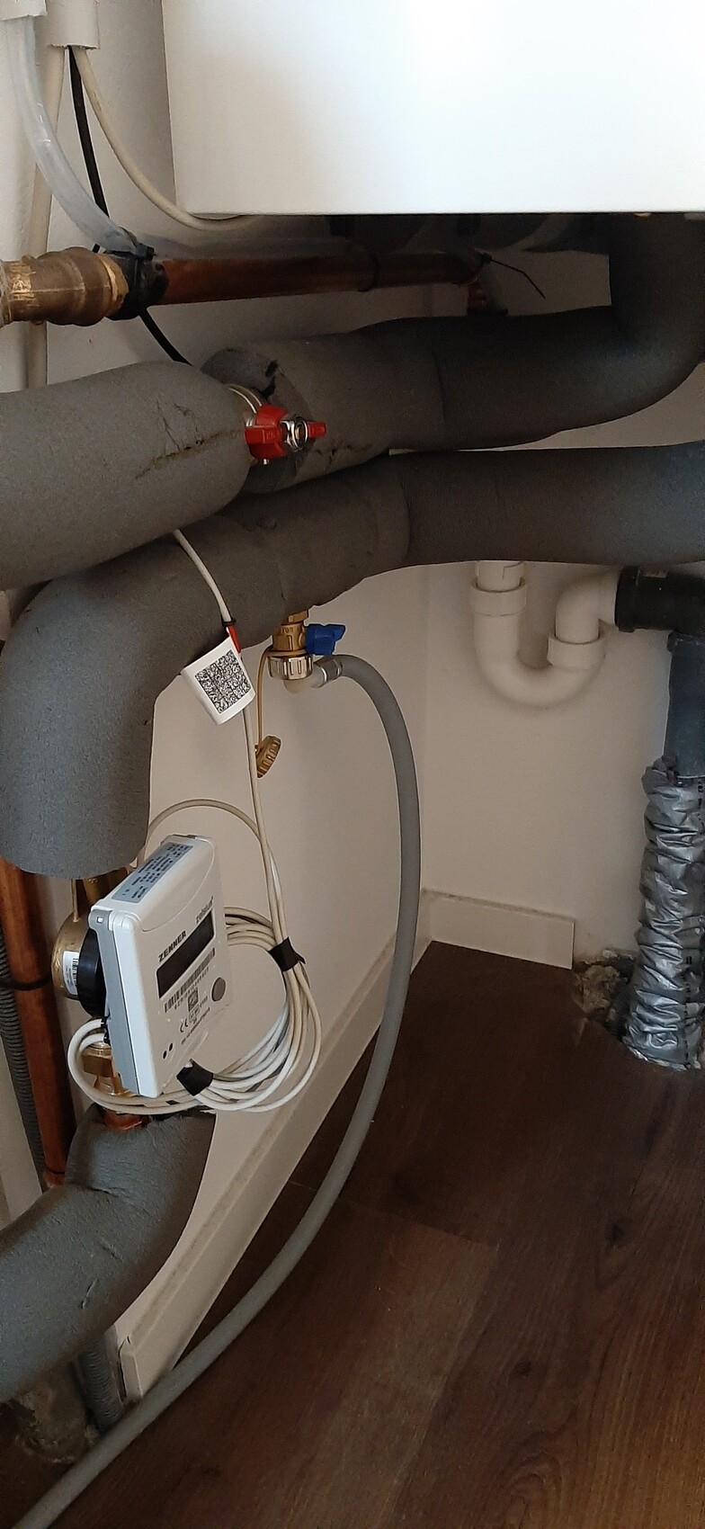

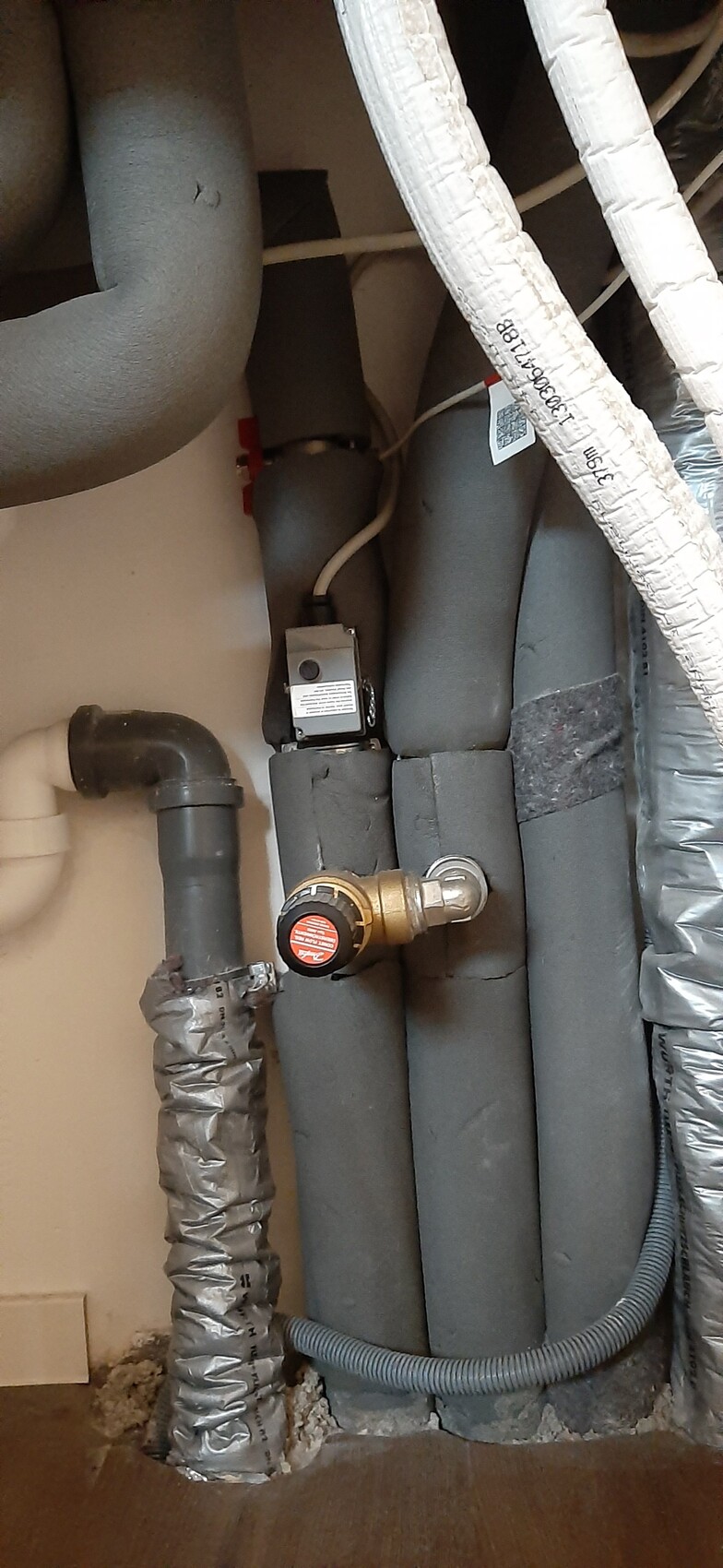

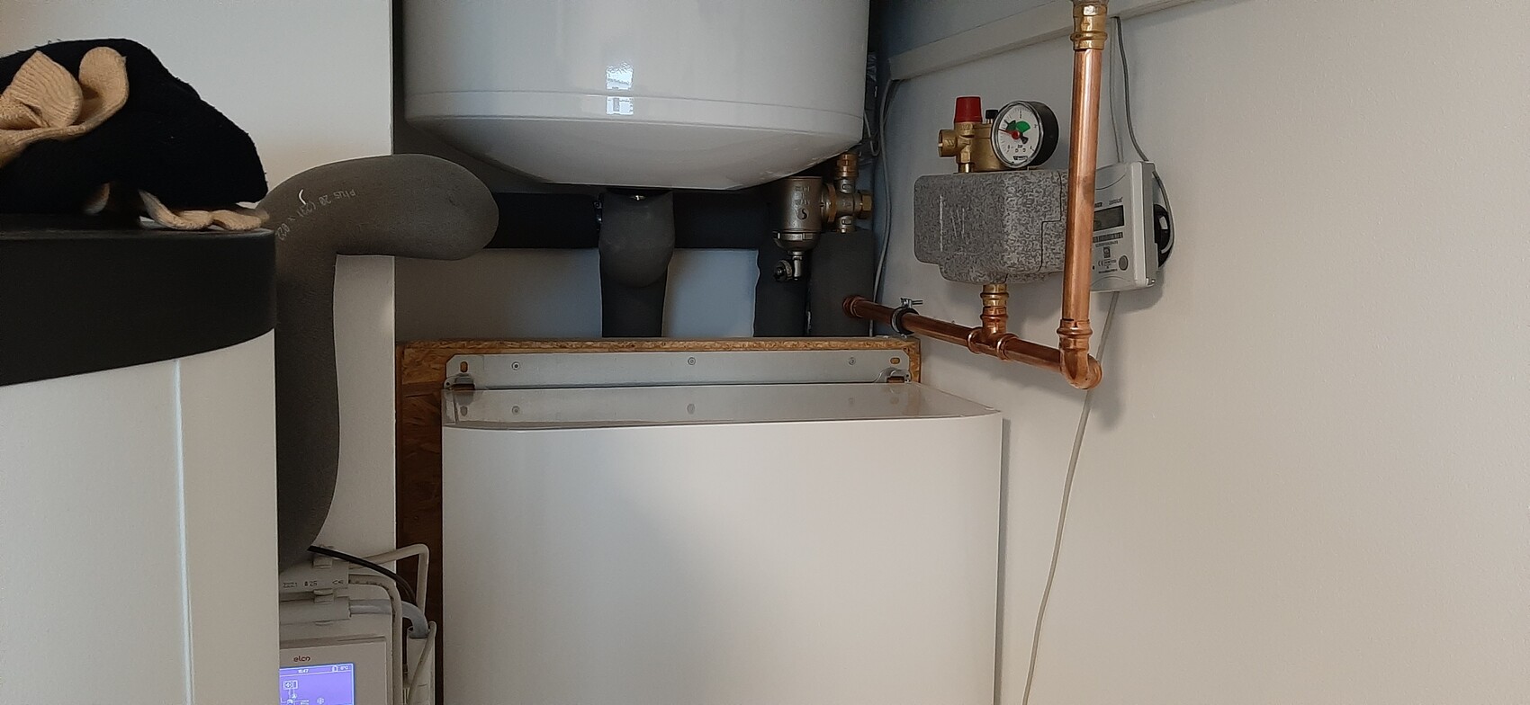

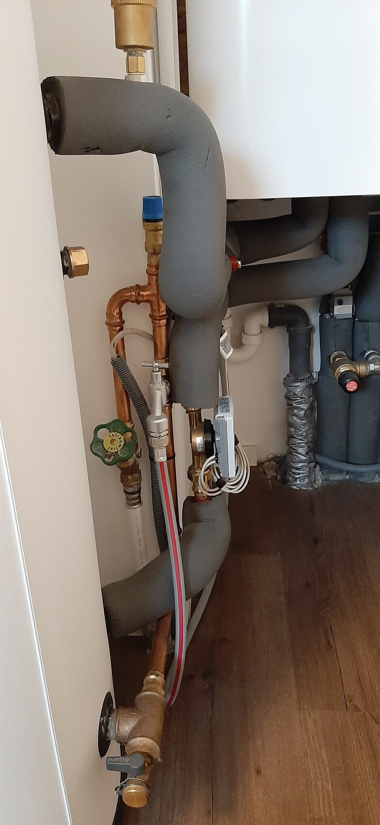

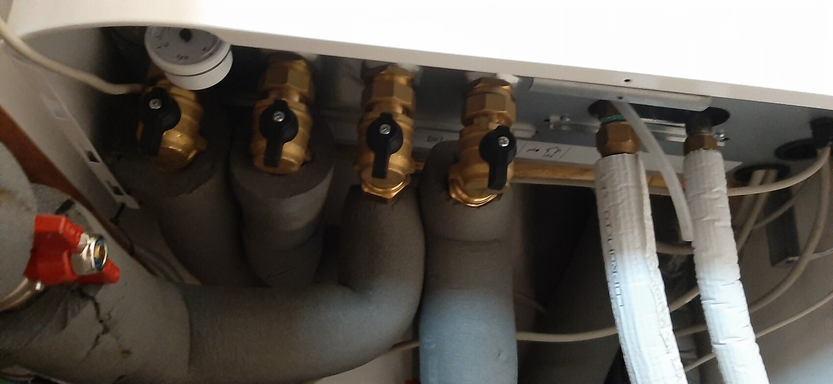

Hello, for the first 2 to 3 seconds the pressure in our domestic hot water line is very high and then stabilizes. What could be the cause? We have an air-to-water heat pump. I have attached some pictures showing individual valves. Could it be related to these? I am concerned that this issue might negatively affect the heating system. The pressure only builds up again afterwards. If I use hot water again shortly after, the pressure is normal. We do not have continuous circulation.

Okay, I reviewed the installation and the hydraulic diagram from Vaillant again. The specified expansion vessel (MAG) for hot water is not installed. As a result, everything flows out smoothly through the valve during hot water preparation.

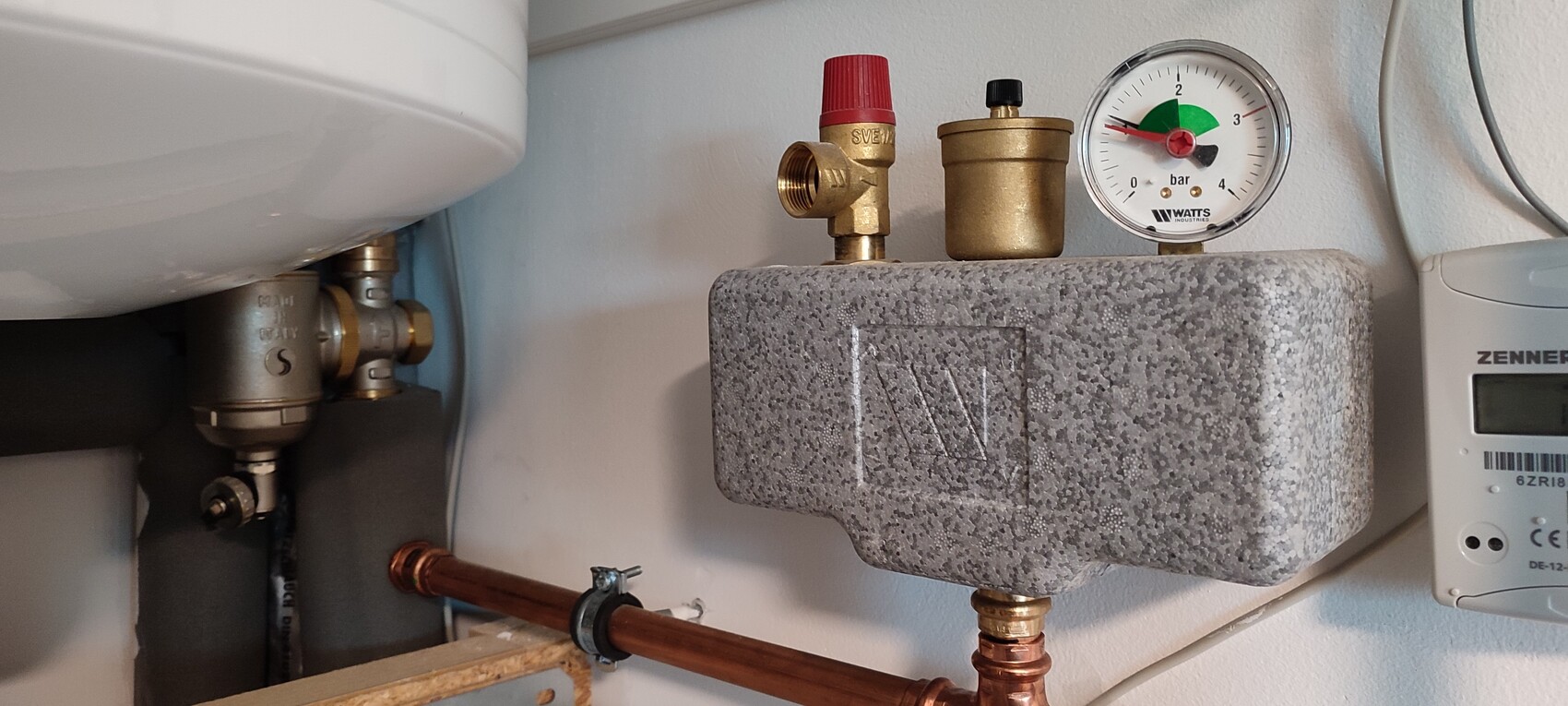

Today, I noticed that the pressure on the safety group is very low. Isn’t that actually contradictory?
Which pressure gauge do you want to check?
