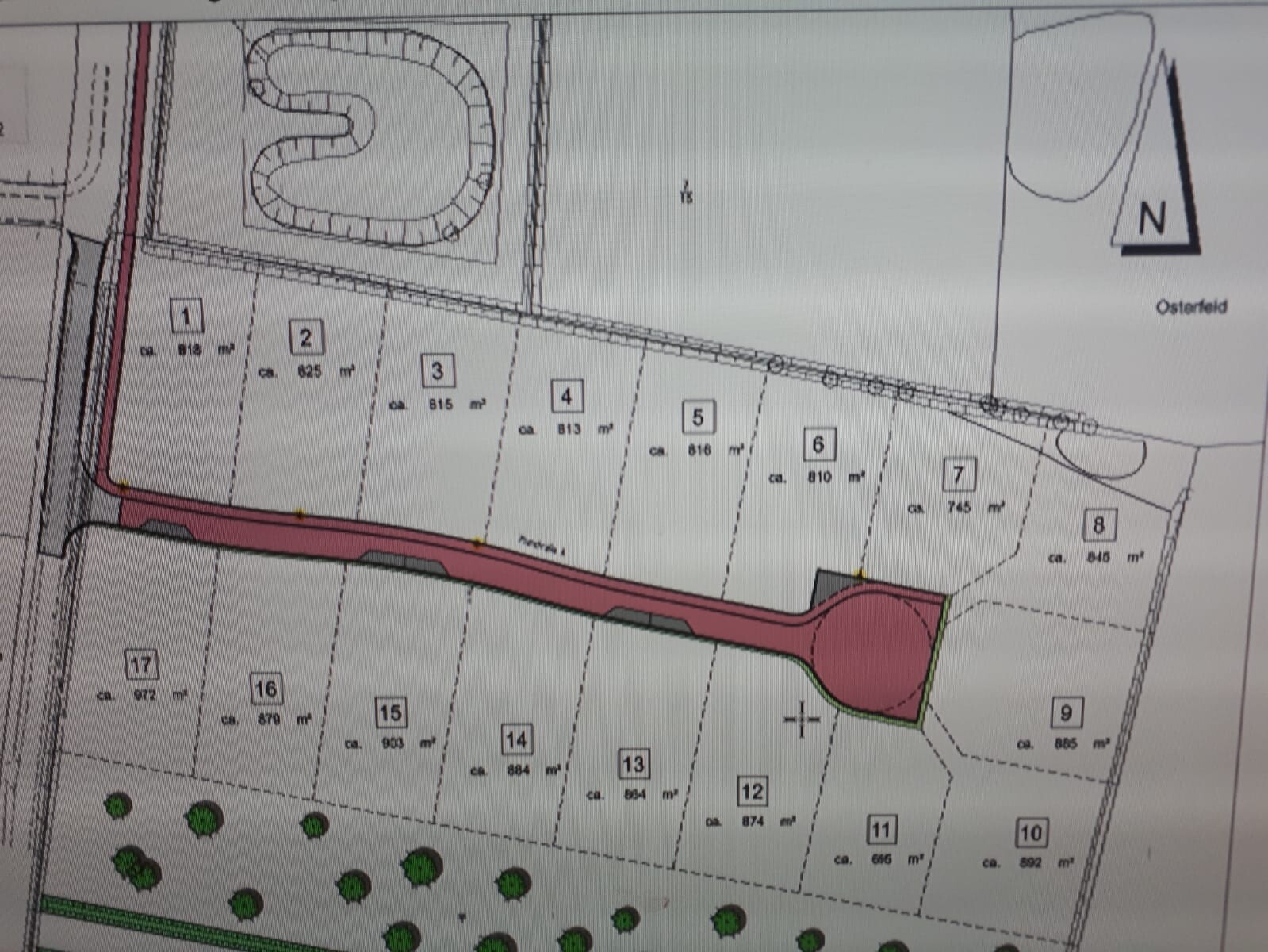

pffreestyler15 Nov 2018 13:57Hello, we are currently developing plot 16 and are now facing the question of the orientation of the solar panels. The house is positioned “sideways” on the plot, following the shape of the lot. This means the front and back have equal distances to the neighbors. The pitched roof is oriented towards the neighbors, so the gable faces the street and the orchard meadow.
I recently had a discussion with the plumbing company regarding the solar panel orientation. I always thought that solar panels should be oriented either south or west. Our roof has an east (with some south) and west (with some north) orientation. Therefore, I assumed our solar panels would be installed on the west side of the roof. Looking at the “older” new development area, the houses with a similar stronger west-east orientation also have their panels on the west side.
However, our plumber tends to recommend an east-facing orientation, arguing that during the months when solar panels deliver noticeable performance, the hot water tank already reaches 60°C (140°F) by midday and then shuts off anyway. He will consult again with Buderus to get their expert opinion.
What are your thoughts on this?
