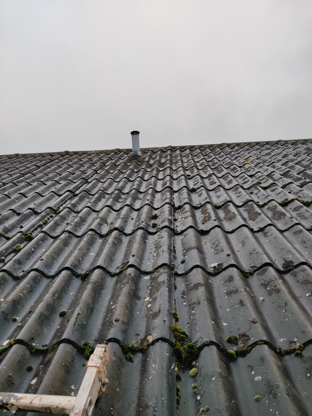

Our house has black roof tiles that don’t look like the typical fiber cement sheets.
Where some of them have slightly cracked, they do start to resemble fiber cement.
Does anyone recognize these or can tell me if they are fiber cement sheets?
Gray, corrugated roof with moss and a chimney pipe, clouds in the sky.

to me, this is the short-wave corrugated sheet known as the "Berliner Welle." It is still being produced today.
Feel free to ask if you have any further questions.
