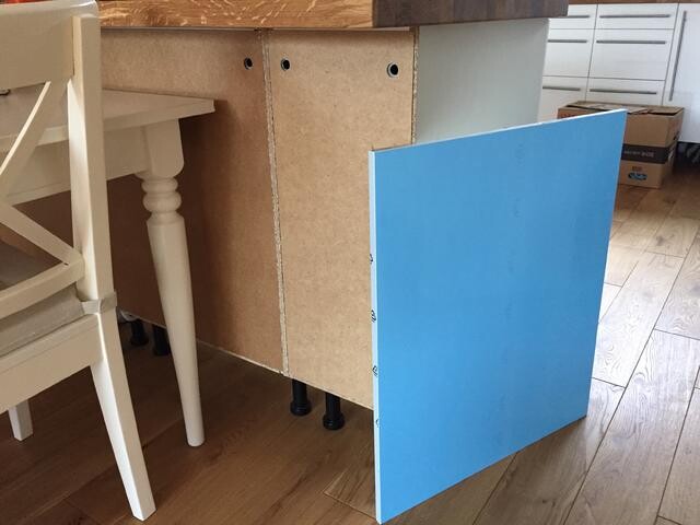

I need to install cover panels on the back sides of several connected cabinets. I’m just wondering how to do this!?
The instructions for the panels only explain how to attach them to one side of a cabinet (which is easy because you have a stable side), but this is not the case for the back side.
I’m sure one of you has done this before, so please help! 😀

Herr rossi8 Jan 2015 12:36Hi Urbisan, I usually prefer gluing over drilling, for example using products from a well-known manufacturer (no advertisement). I also use short screws with large washers, which I screw through the holes of the hangers at the upper part. At the lower part, I screw directly through the back panel with the washer.
Regards, Herr rossi
