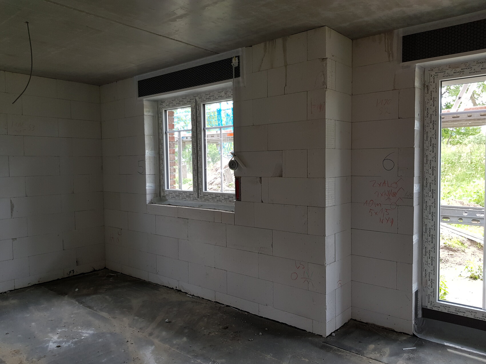

Our manually operated built-in roller shutters have exactly 20cm (8 inches) above the windows...Ours are at least 20cm (8 inches) as well. Here is a picture:

At the moment, there is no roller shutter box installed. The roller shutters are simply mounted on the exterior façade above the windows. I believe that is called surface-mounted roller shutters. You are correct about the term. However, don’t assume they are "simply" installed: normally yes, but apparently not in this case. Usually, they are installed at a height where there is still a lintel above the window, but in your case, it is already the ceiling. So, the strap or crank drive input would have to be located far down on the box and then extended through a hole in the wall and redirected. This is at least not straightforward and absolutely impossible if the box is not designed to have the input near the bottom. I could imagine that you might want or have to use a model that only allows electric operation with remote control and no alternative. Hence my question about the sketch of the unit.
