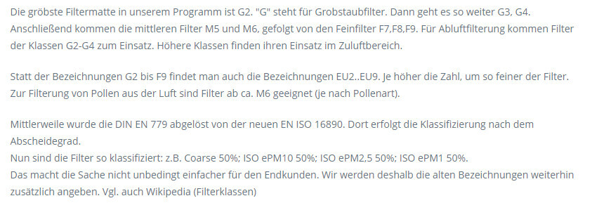

nordanney18 Jul 2021 07:28Sunny_Girl schrieb:
Is it enough to just pay attention to the designations G2, G3, and G5, or do you also need to consider other factors like ISO Coarse, etc.?So both are basically the same, just with different labels.
Sunny_Girl18 Jul 2021 14:00Thank you for the information. I was just surprised to see Iso Coarse 30% listed once and 45% on G3 filters another time. Also, that there are materials with different airflow velocities. None of this is familiar to me.
