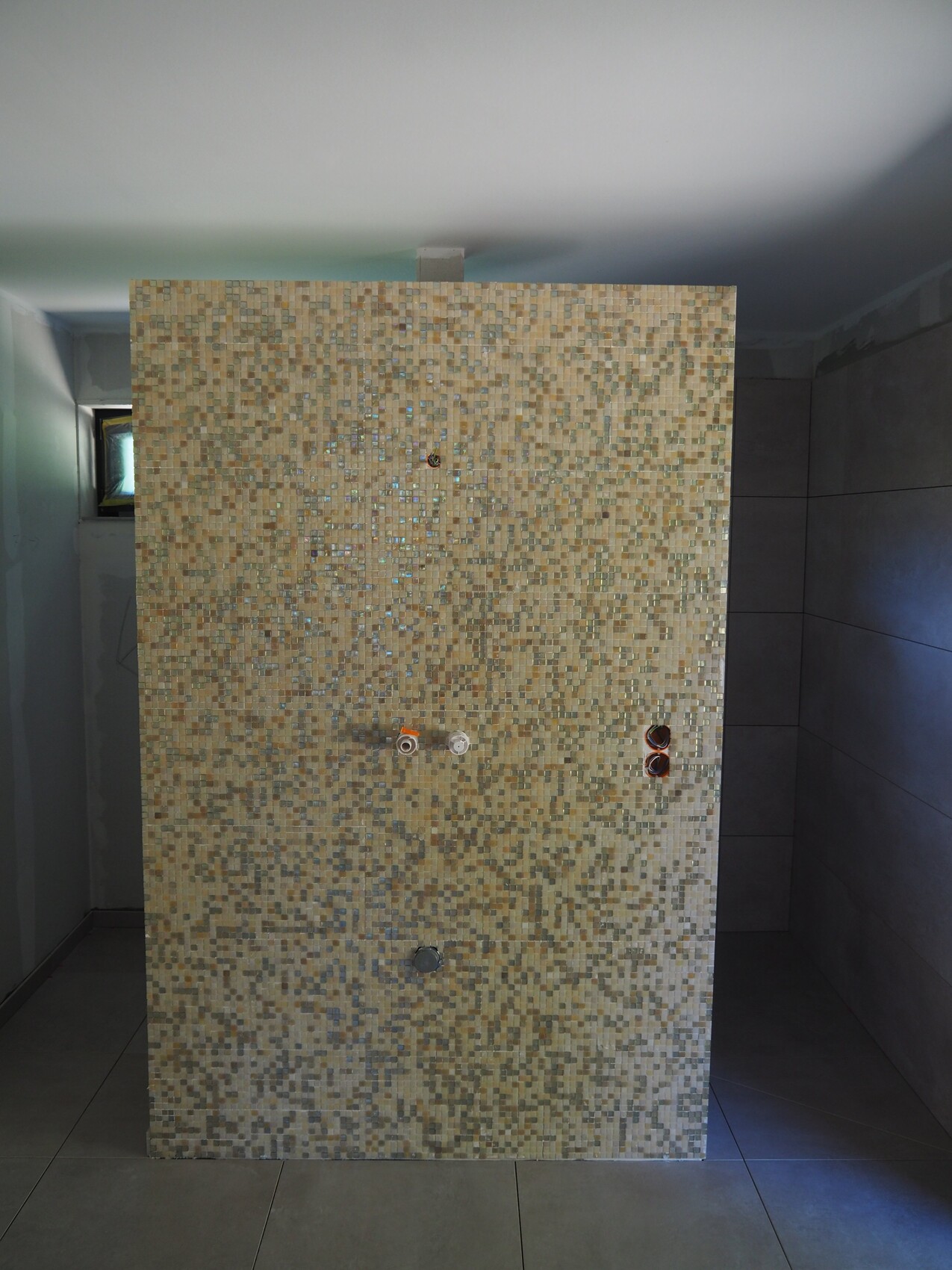

nordanney1 Jul 2019 16:23hampshire schrieb:
Here is another example without corner profile:But in this case, you also have the special situation of a freestanding wall with mosaic tiles. It works here without a track as well.P.S. Is it intentional that every single mosaic sheet is visible? I don’t find it very attractive or well-tiled.
hampshire1 Jul 2019 19:59That’s how it is; it still needs to be grouted. Then there will be a new photo, including one from the side.

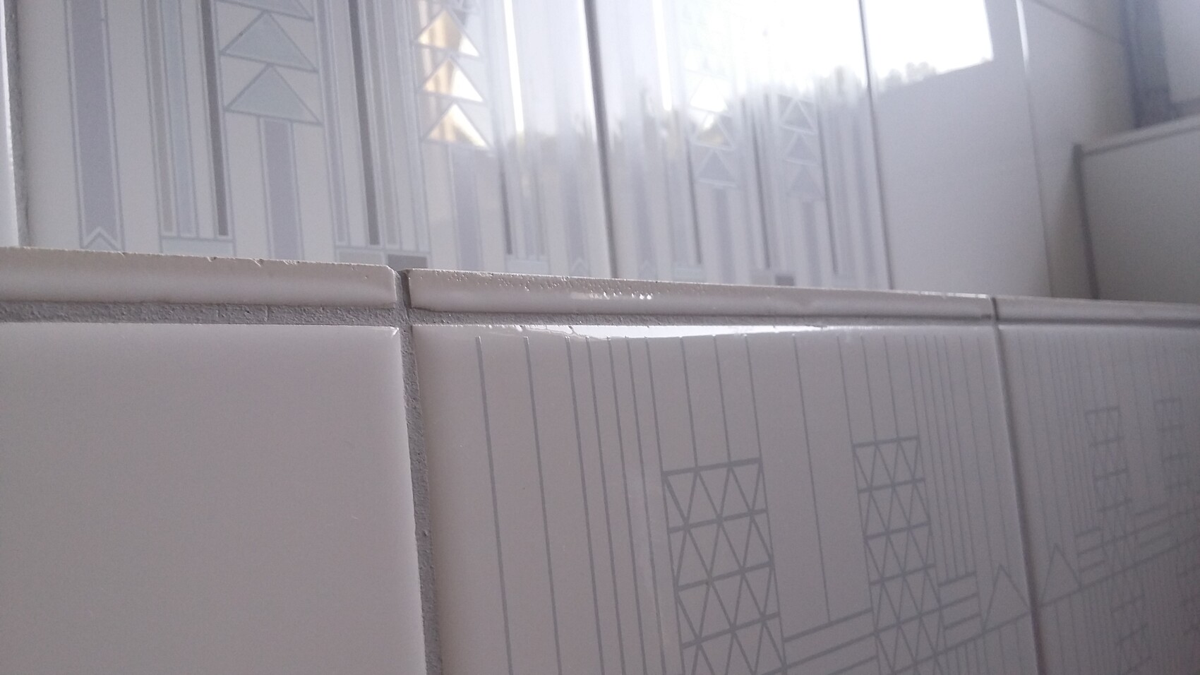

Annedefrance1 Jul 2019 20:11Domski schrieb:
I can’t tell from the picture whether the glaze extends all the way around. I’m referring to corner tiles that have a rounded edge with the glaze wrapping around the curve. These have been around for over 100 years.
Try searching for "tw-edge tile" — that’s what I mean.Yes, they are. Not perfectly uniform, but that actually makes it look more interesting. I also looked at the ones you mentioned. Very nice, but obviously intended for a slightly different application. Here’s another picture from our large bathroom.
