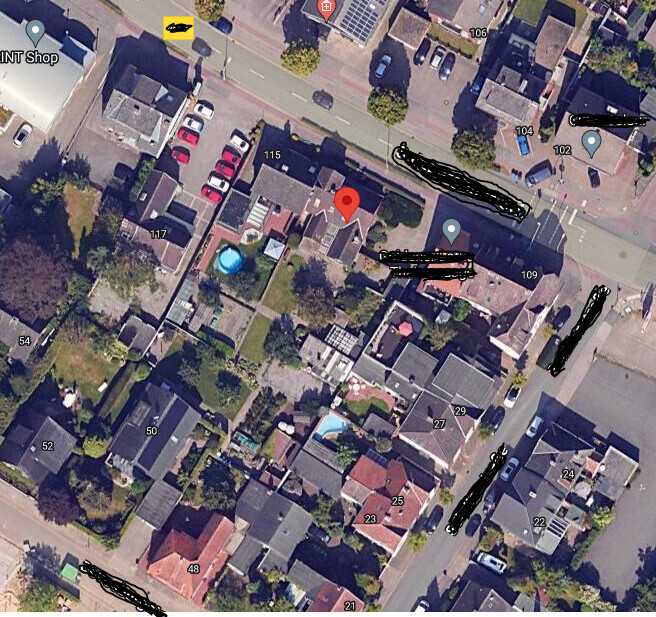

What do the surrounding buildings look like? How many floors and what height? An aerial photo helps to assess the neighborhood.
there is a parking space regulation.
Table on residential buildings: single and two-family houses, area information and notes
In the immediate vicinity, there are apartment buildings, semi-detached houses, and single-family houses ranging from 1.5 to 3 stories.
Aerial view of a residential area: houses, streets, cars; red pin marks the target house.
