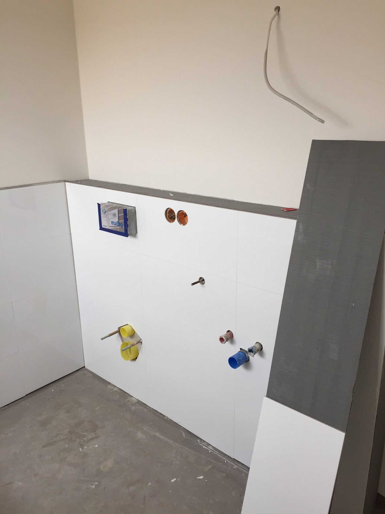

Our toilets will be finally installed next week. The connections are already in place (see photo). Is it still possible to adjust the height by a few centimeters higher or lower during installation, or is it fixed now? The original agreement was 47 cm (19 inches) to the top edge.
Kuechenbereich im Bau mit freiliegenden Wasseranschluessen und Fliesenwand

It’s fixed.
How else should it work? The mounting bolts for the water supply and drain determine the height.
You can only go higher by using a taller toilet seat.

Yes, there are options to address that.
Try searching for "botched job kit".

matte1987 schrieb:
Yes, there is something you can do about it.
Just Google “Pfuscher Set.”
At first, I thought the term “Pfuscher Set” was meant ironically – but it actually exists...

I haven't tried it yet. But it looks really good.

However, it must be said that with the DIY kit, you usually get only about 25mm (1 inch) of additional height.
