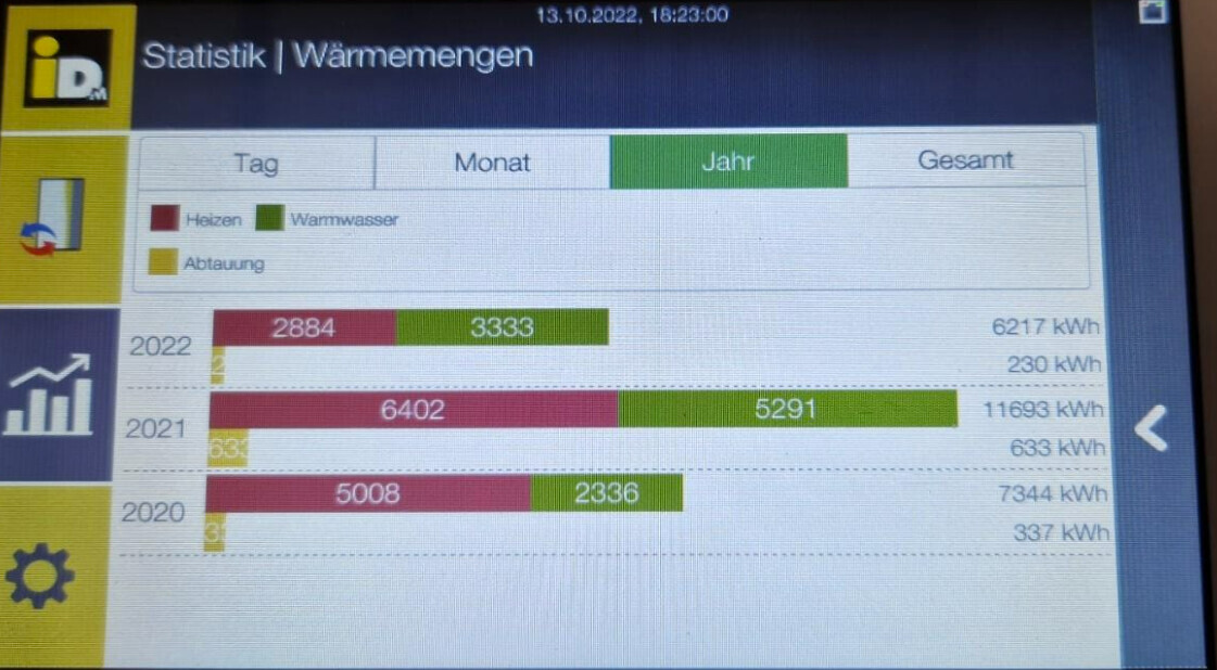

WilhelmRo14 Oct 2022 14:37WilderSueden schrieb:
Heating demand of 3250 kWh/year Wow – okay, I checked:
11,700 kWh heating demand
And here:
3,900 kWh electricity demand for heating and domestic hot water
Do you have something like this for me as well? Have you been living there that long already?

WilhelmRo17 Oct 2022 08:29WilderSueden schrieb:
What kind of house do you have? Size, standard? 180 sqm (1940 sq ft)
KfW 55

WilderSueden17 Oct 2022 08:52WilhelmRo schrieb:
180 sqm (1937 sq ft)
KFW 55180 x 35 = 6300 kWh/year calculated heat demand, so you are very close to the actual demand. A large house and one step lower in the standard makes a significant difference. The COP of 3.45 is quite moderate, and I also find the amount used for domestic hot water to be far too high.
