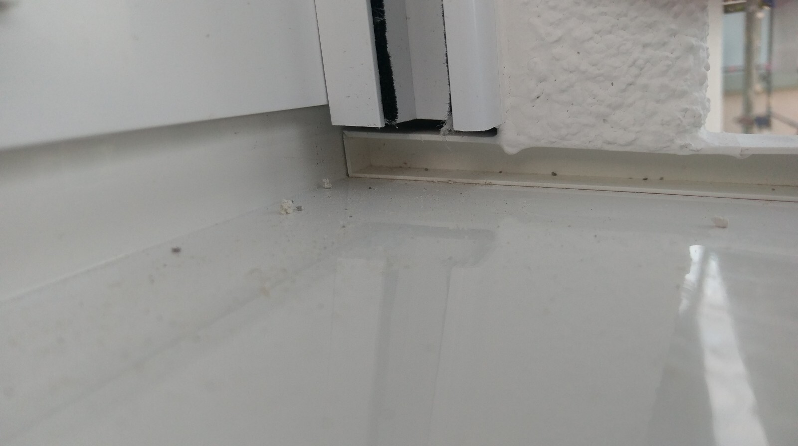

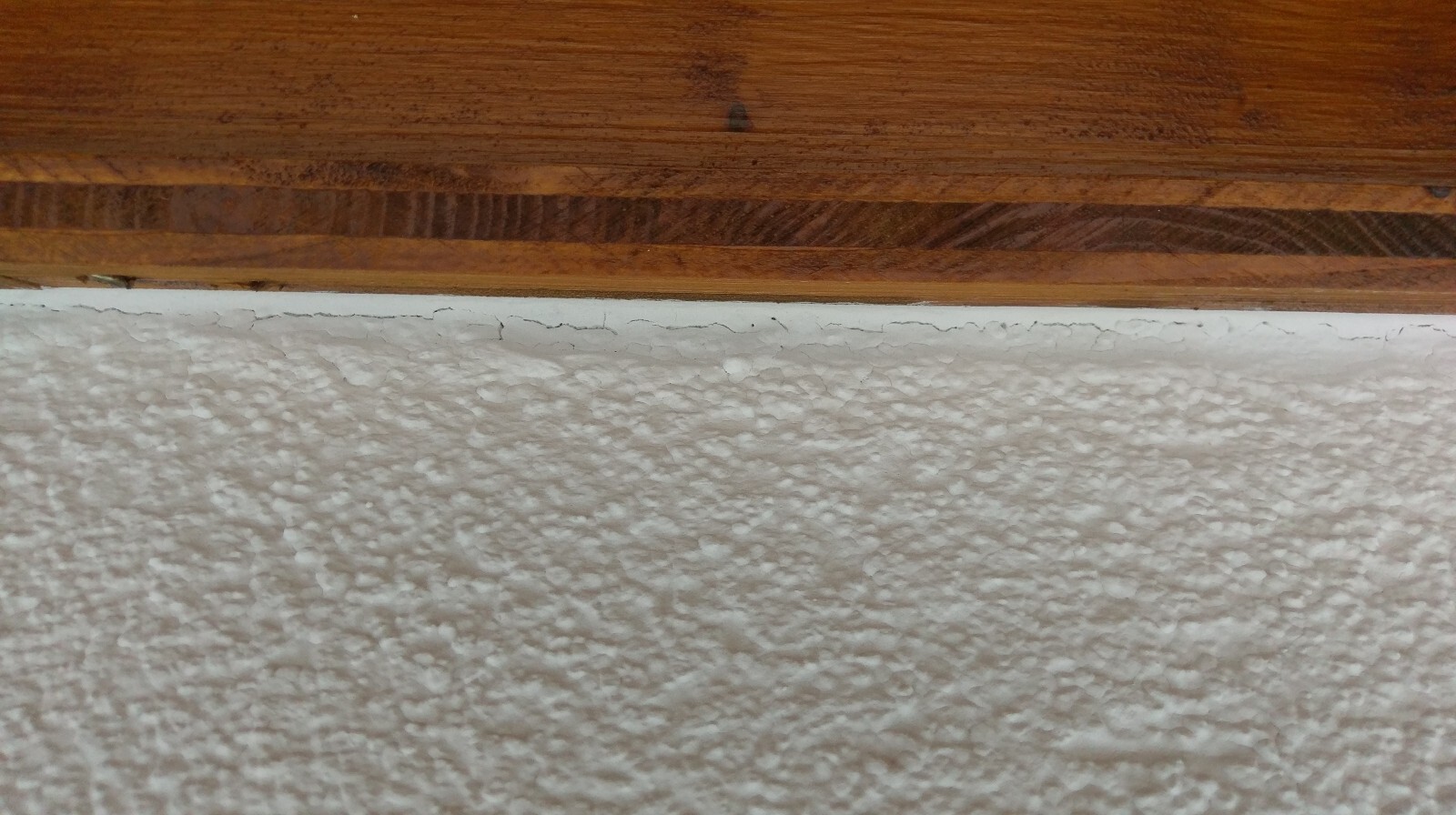

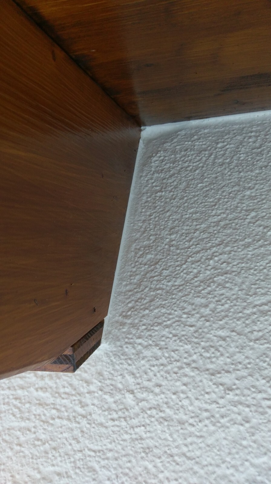

Our house is almost completely plastered; I have uploaded a few pictures for you.
The transition between the roof and the wall already shows a small crack.
Am I being too critical?
Thanks for your opinions.
Close-up of a window frame with a gap and sealing defect on a white wall and floor.
Close-up of a wooden trim in the inner corner on a white, textured wall.
Close-up of a wooden trim above a rough white wall with a plaster crack.

There should be an acrylic joint there.

From the few pictures, everything actually looks fine and even very neat.
For the roller shutter track, a plastering strip could have been used, but it is not mandatory.

A crack in a joint is completely normal and is usually excluded from warranty coverage. Houses settle and shift.
