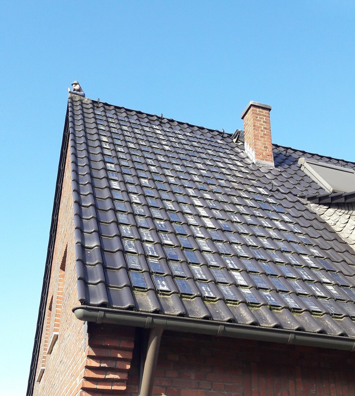

Appearance? – What are you trying to hide? Do you look at your roof every day? I would argue that this reason is greatly overrated. You get less performance for more money. That’s an option if you have extra money to spend. But money is usually one of the things you don’t have left over when planning a house. That said, I don’t want to preach or convince you—you can (and will) do whatever you prefer.
In my opinion, whether it’s my system, my neighbors’ or in the surrounding area… no one really looks at or pays attention to whether it’s an on-roof or in-roof system.
By the way, here is a photo of a somewhat older in-roof system, discovered two weeks ago. Appearance… hmm…
Gable roof with dark roof tiles, red chimney and blue sky.
