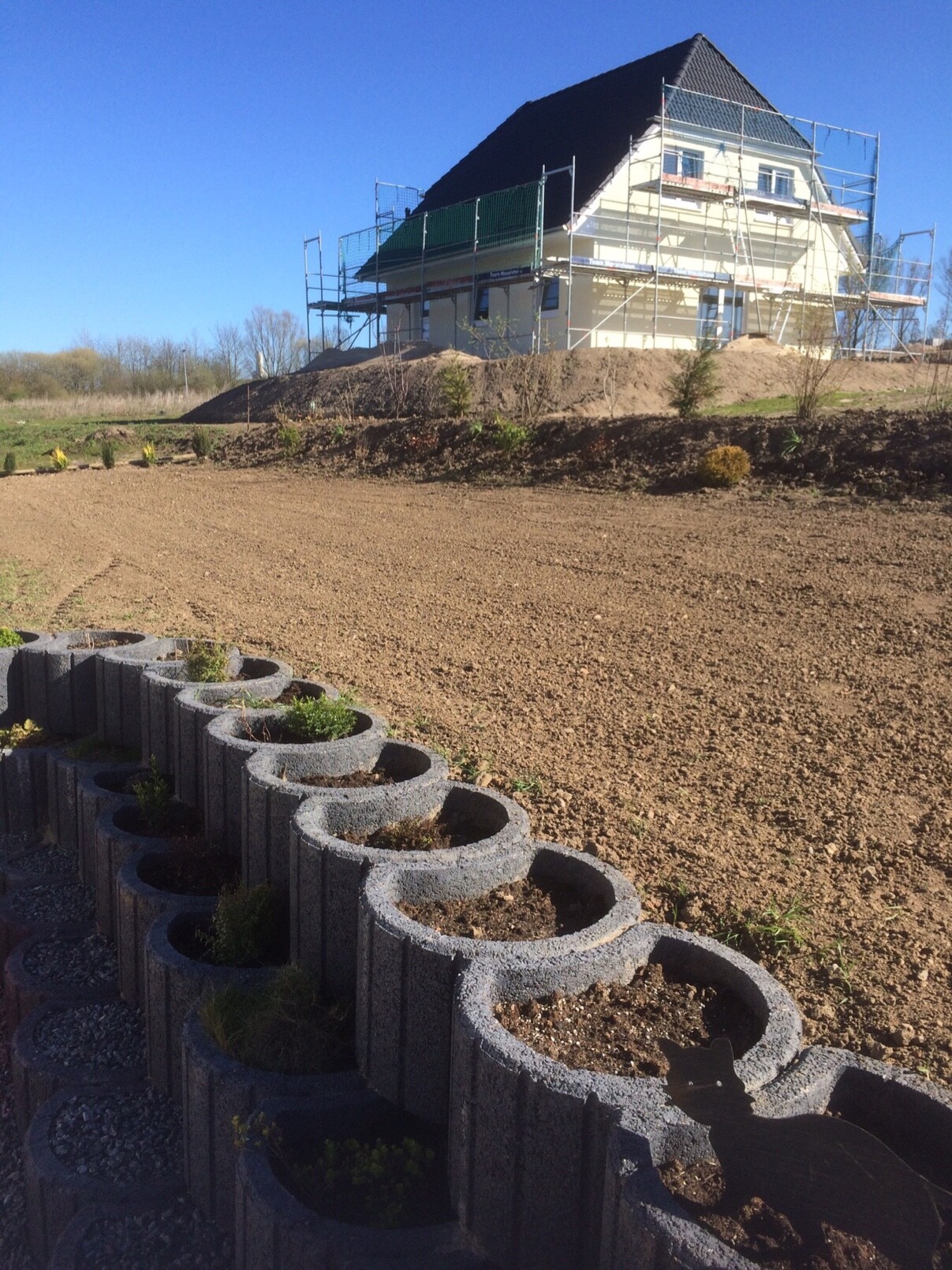

maybe some of you still remember our 42m (138 feet) long slope, which we initially wanted to stabilize with something solid at a 90° angle. Since all those solutions would exceed our budget, we decided to do it the natural way and create a slope that will be planted with groundcover bushes. We will be receiving soil in the next few days to shape the slope (there is still quite a bit of soil missing to reach the border).
Now the question: Do I need to compact the soil specifically? Can I do this with a wheelbarrow, shovel, and manual tamping, or does it have to be done with an excavator?
Then a slope stabilizing net or mat will be laid on top to prevent soil erosion. Do you have any tips on what works well and is affordable?

HilfeHilfe4 May 2018 12:38Retaining wall construction and backfilling not an option?
HilfeHilfe4 May 2018 22:36Evolith schrieb:
Way too expensive for 42 meters length and 1.2 meters height 30 meters length and 1.2 meters height and 2,500€ material cost
HilfeHilfe schrieb:
30 meters (98 feet) long and 1.2 meters (4 feet) high with material costs of €2500If it were just the materials. We have received quotes, and none were under €8000.We also considered Nordlys planting rings. However, our soil is quite marshy below the slope. We will need to use a lot of gravel to create a stable foundation. Unfortunately, that pushes the cost above €5000. And we can’t do it ourselves. My dad has back problems (herniated discs), and I’m not allowed to do heavy lifting for the next few months.
