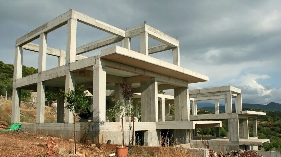

Jesse Custer23 Dec 2024 08:26nordanney schrieb:
So this is how you want to build, right?
There seems to be little flexibility. HOWEVER, you definitely need to add a thick layer of external insulation to meet the required performance standards. This was exactly what I was thinking – but you can only build like this in southern regions. These houses are simply a disaster when it comes to insulation and soundproofing…
The only advantage is that you can take years to complete the build – for example, similar structures in Tuscany are often only finished after many years…

The only advantage: this way you can build over several years – for example, such structures in Tuscany are only completed after many years. That is precisely a major part of the (in my opinion, unrealistic) dreams of the OP.
