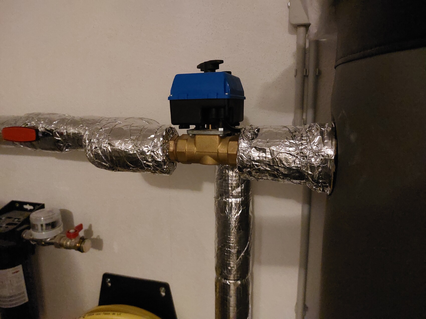

This is how it looks in our place...
[ATTACH type="full" width="182px"]92877[/ATTACH]
Visually, it looks a bit plain... but it’s in the basement, so whatever.
Just ask him!
