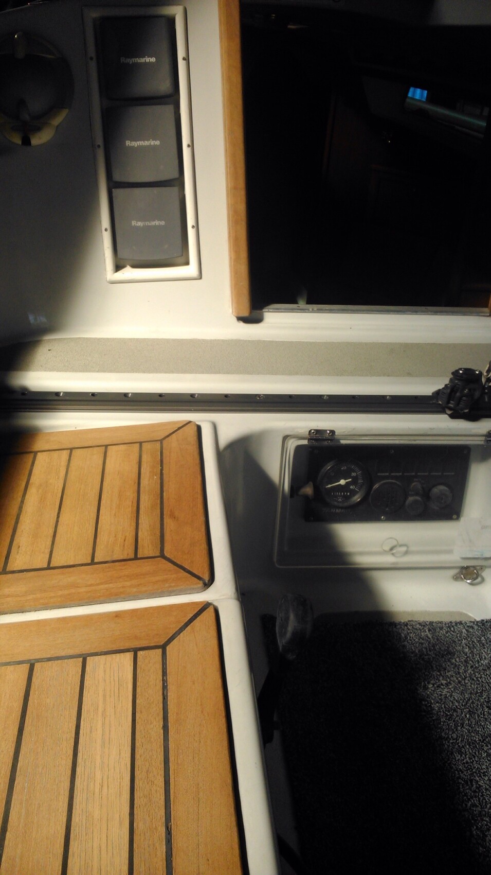

Look at the picture. These are solid teak strips, glued onto the deck and then sealed. It doesn't have to be black; I just thought it looked nice here. The photo is from autumn 2014. Despite sun, rain, salt, and foot traffic, everything has remained tight up to now. I did it myself. I’m a bit proud of that. Smile Karsten
