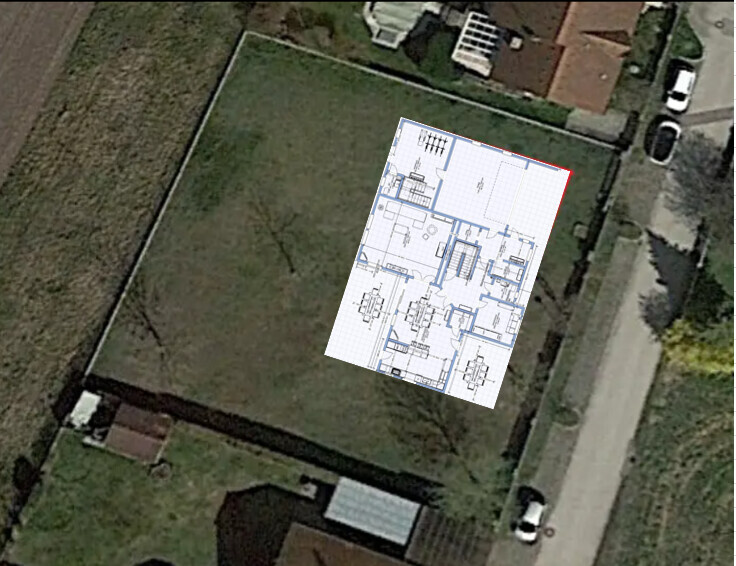

Satellite image of a residential plot overlaid with the house floor plan
bwollowb
4 Aug 2023 12:12
hanghaus2023 schrieb:
You have little space in the south if you don’t build right up to the boundary.
Well, 10 meters (33 feet) to the property line is already quite a lot for our area! You are only allowed to build either directly on the side property line or at least 3 meters (10 feet) away.

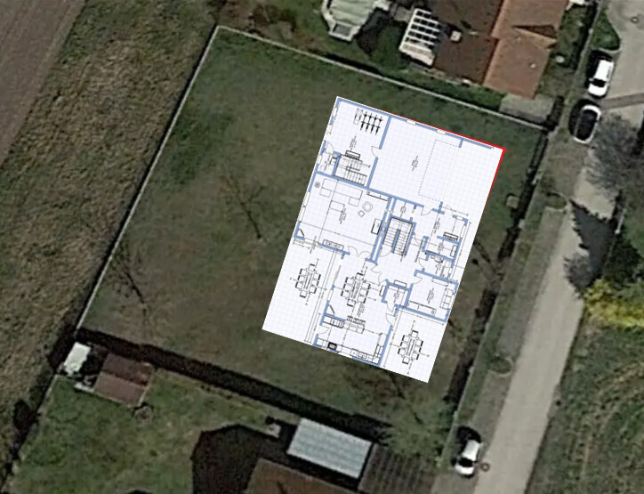

I tried to analyze this in more detail.
Satellite image of a plot with an obliquely positioned floor plan on the lawn.
35m (115 ft) - 22.5m (74 ft) - 3m (10 ft) = 9.5m (31 ft). The house to the south is then about 15m (49 ft) away.
