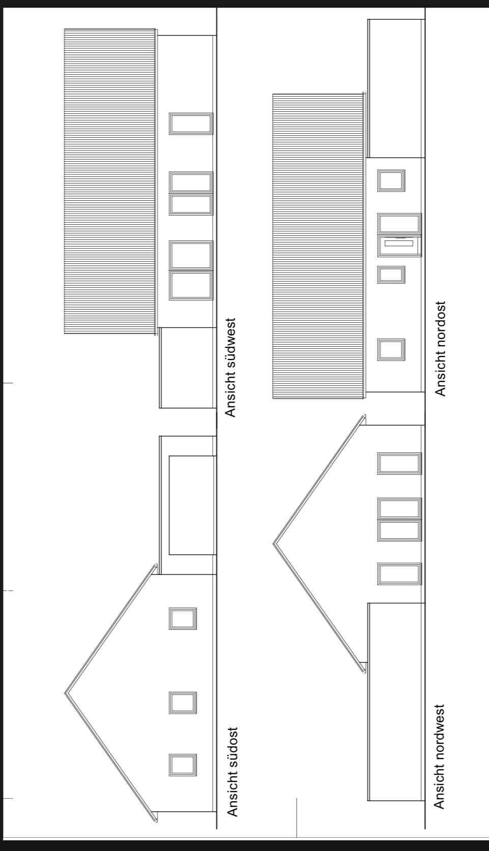

However, I am not yet satisfied with the window planning. The terrace will be on the long side in the south/west. A large sliding door would be great here. The current arrangement seems, in my opinion, quite cluttered and not harmonious. I would really appreciate some input on this. In the garage, would it be better to have windows or perhaps just a strip window?

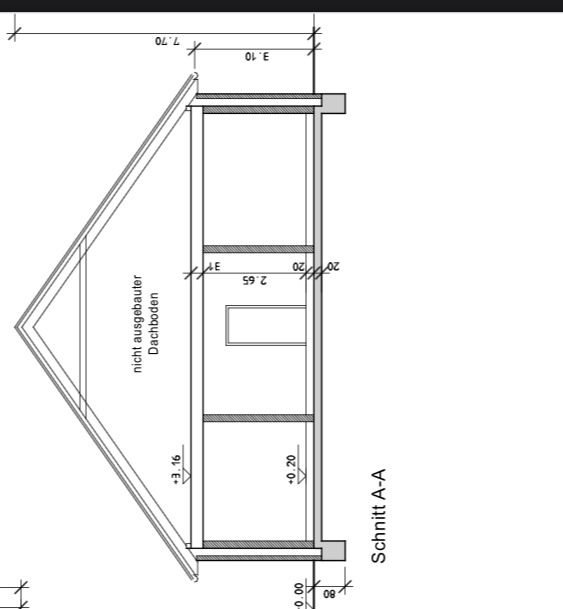

Since I am not a fan of hip roofs, I decided on a gable roof. This also creates more space in the attic for future expansion. There is still the idea to adjust the roof pitch to 30 or even 25 degrees and build up a knee wall. However, the planner would need to draw this for me so I can evaluate the exterior view before making a final decision.
For now, I am planning a wooden beam ceiling, mainly for cost reasons. However, if children later live in the upper floor, I am worried that I might regret this decision. What do you think?

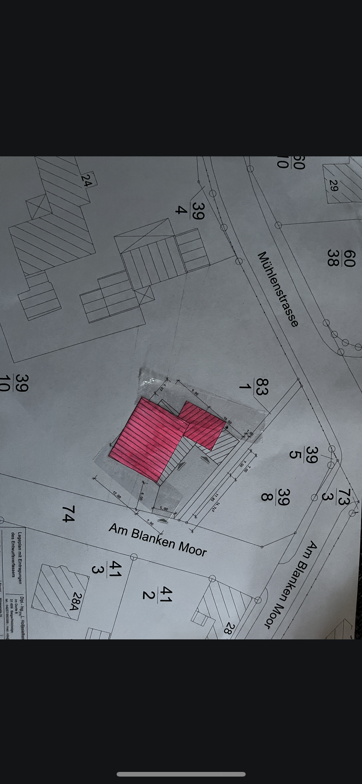

hanghaus202325 May 2026 15:37Is there also a site plan showing the house?
