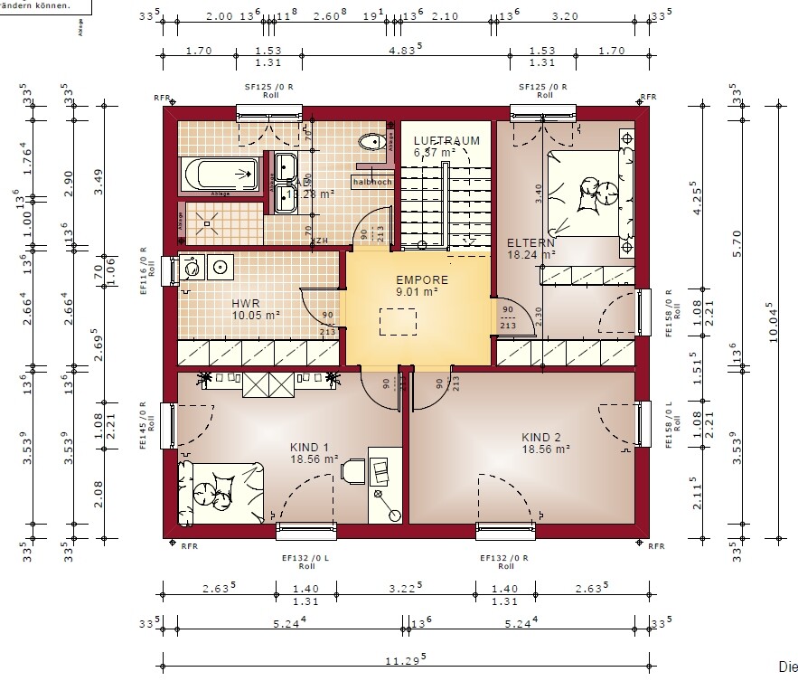

- Walk-in closet upstairs in the master bedroom is not essential; the bedroom could be made slightly smaller as a result.
- Is the bathroom design upstairs okay? Is it bright enough with the window in this position?
- Is there enough space in the hallway downstairs for a wardrobe?

- The wall with the TV in the living room could be moved further towards the office, making the living room bigger but keeping the office large enough.

pagoni202028 Jul 2020 20:56Pinky0301 schrieb:
The 70cm (28 inches) passages are not very spacious.I feel the same; in my opinion, the 70cm (28 inches) space to the window makes little sense.11ant schrieb:
