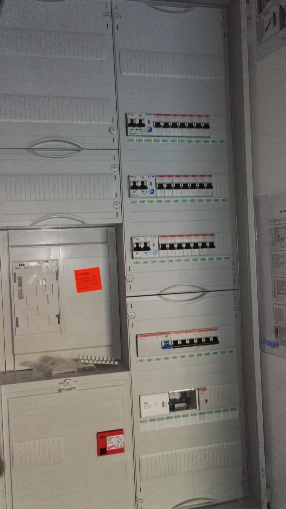

Could you send me a picture of your distribution board? I’ll see if I can take one this evening where you can actually see something. Unfortunately, I don’t have proper lighting there yet.

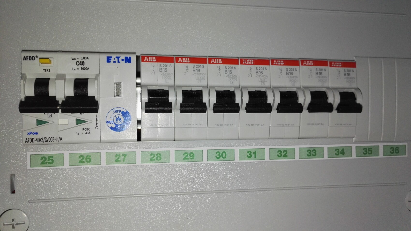

Could you send me a picture of your distribution panel?I almost forgot again, here are two pictures showing the inside of the distribution cabinet. The circuit breakers next to the residual current circuit breakers are simply divided among the different rooms/devices.seat88 schrieb:
So, it’s not one switch per circuit, right? No, at least not in my case.
