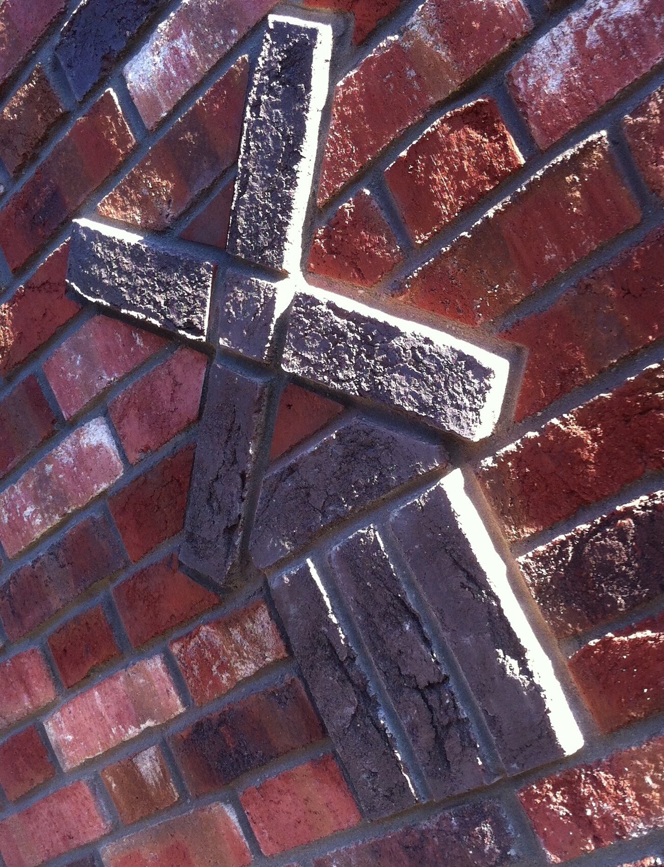

kkk2727296 Nov 2017 08:18Especially when grouting immediately ("grouting in the plastic"), there is a much higher risk of staining because the consistency of the mortar for the outer wall is much more plastic compared to grouting done afterward. In the latter case, the consistency is more chalky.
In my case, grouting was done immediately as well. Here, it is called "grouting with a hose." A piece of garden hose is used to shape the joint.
Different joint colors can also result from varying mix ratios of water and outer wall mortar. This needs to be done quite precisely.
Attached is a photo of a wall grouted with a hose. The joint is set slightly recessed, which gives the brick a more rustic appearance.
