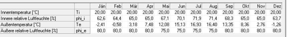

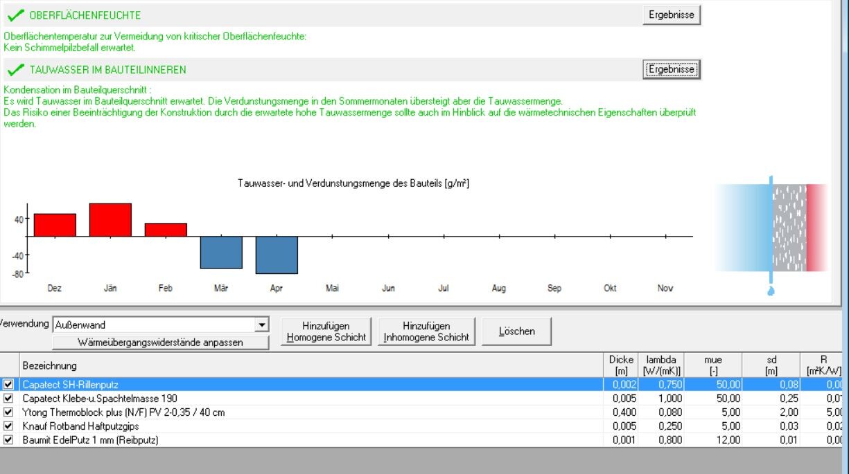

Attached is the construction as planned and also as recommended by Ytong (exterior plaster).
I’m particularly unsure about what to use for the interior plaster. Would a base coat with a higher µ-value be a better choice? Usually, the vapor resistance should decrease from inside to outside, but here it would be the other way round. Or is this not critical due to the mechanical ventilation?
Is the low moisture loss shown in the attachment negligible, or do you have suggestions on how we could improve this?
Thanks in advance!
