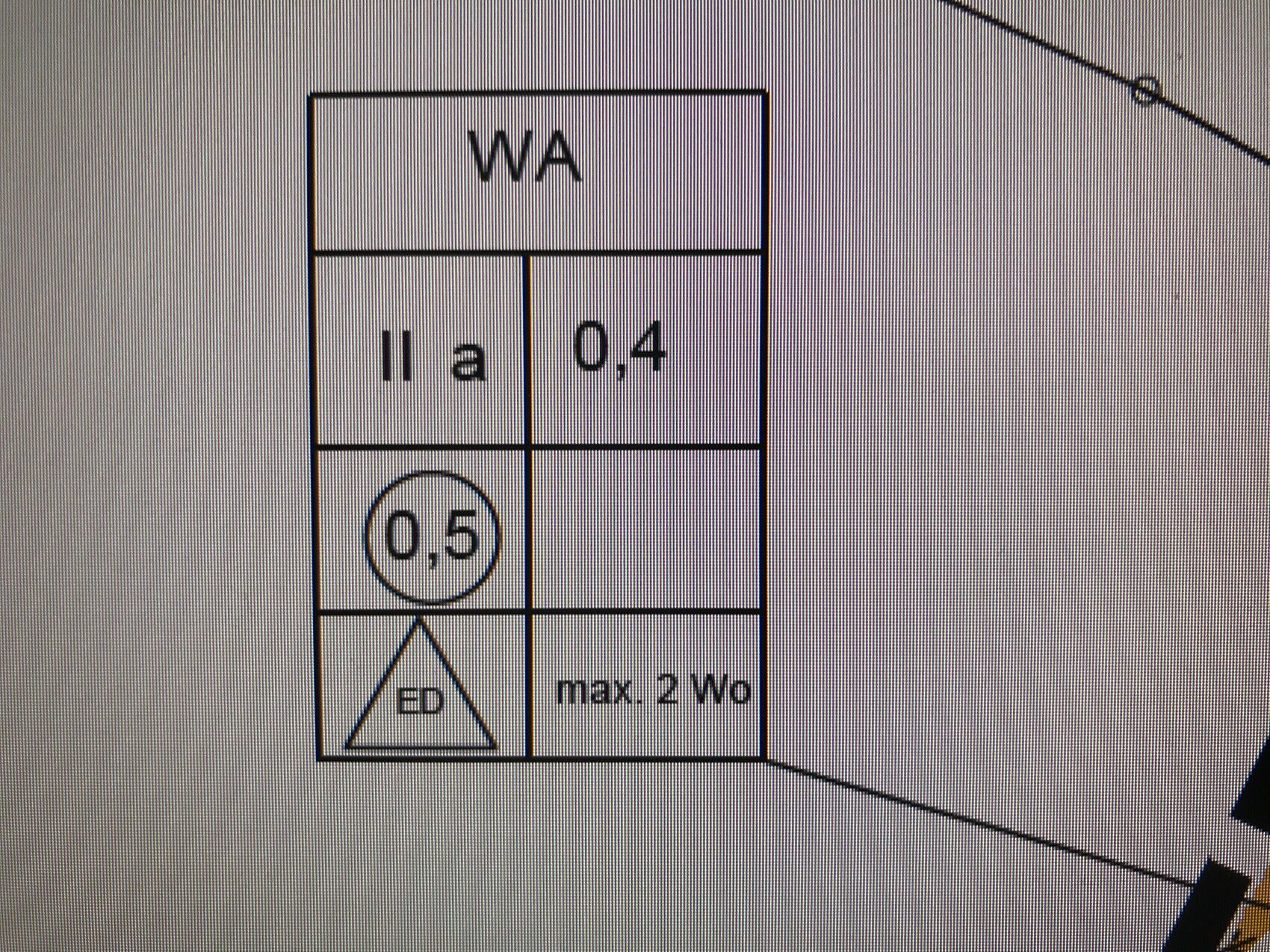

What "a" ("deviating construction method") means after II for the number of floors in the development plan, I did not see explained. § 6 Deviating construction method according to § 22 subsection 4 of the Land Use Ordinance
In the planning area, single-family and duplex houses are not allowed to exceed a maximum length of 25 meters (82 feet) as defined in § 22 subsection 2 of the Land Use Ordinance.

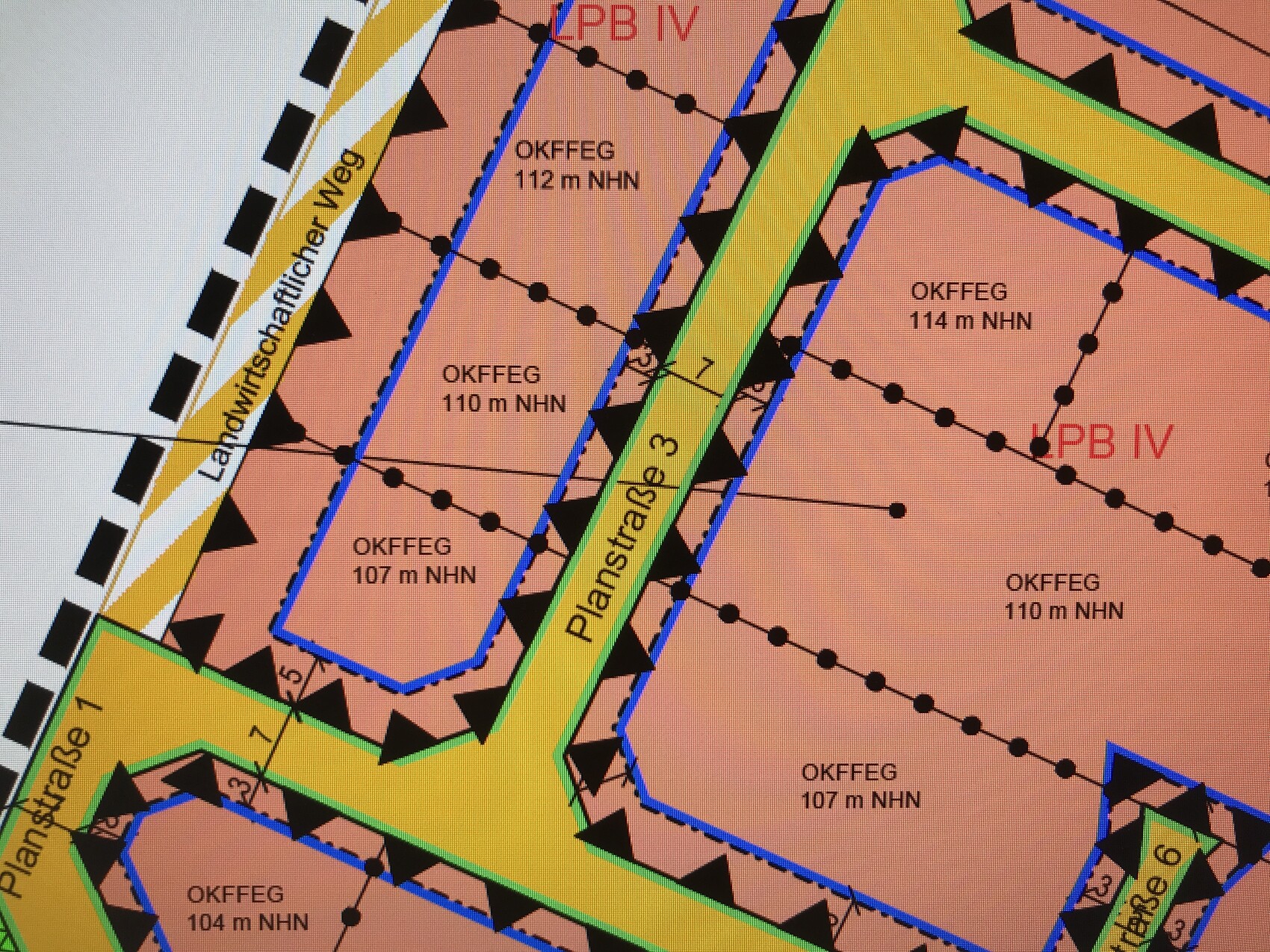

I haven’t found an elevation plan yet Have you found a site plan ("Building Plot No. 1")?
Escroda schrieb:
In "my" development plan, the terrain slopes upward to the north. yes, of course. It was already too late

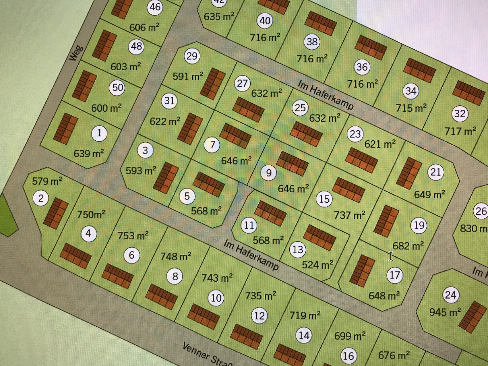

Guido198030 Jan 2019 09:29So, the site data/dimensions and the specifications from the zoning plan are now fully available.
It’s a pity that the city villa probably won’t work out.
Are there any site-related constructive suggestions regarding the house construction method? The living area should be as large as possible while complying with the zoning plan. The terraces/balconies should face south, and the house is planned to include a basement.
Is it possible to determine the orientation of the house based on the zoning plan? Should it be positioned lengthwise or widthwise? It is shown lengthwise, with the longer side running from north to south.
