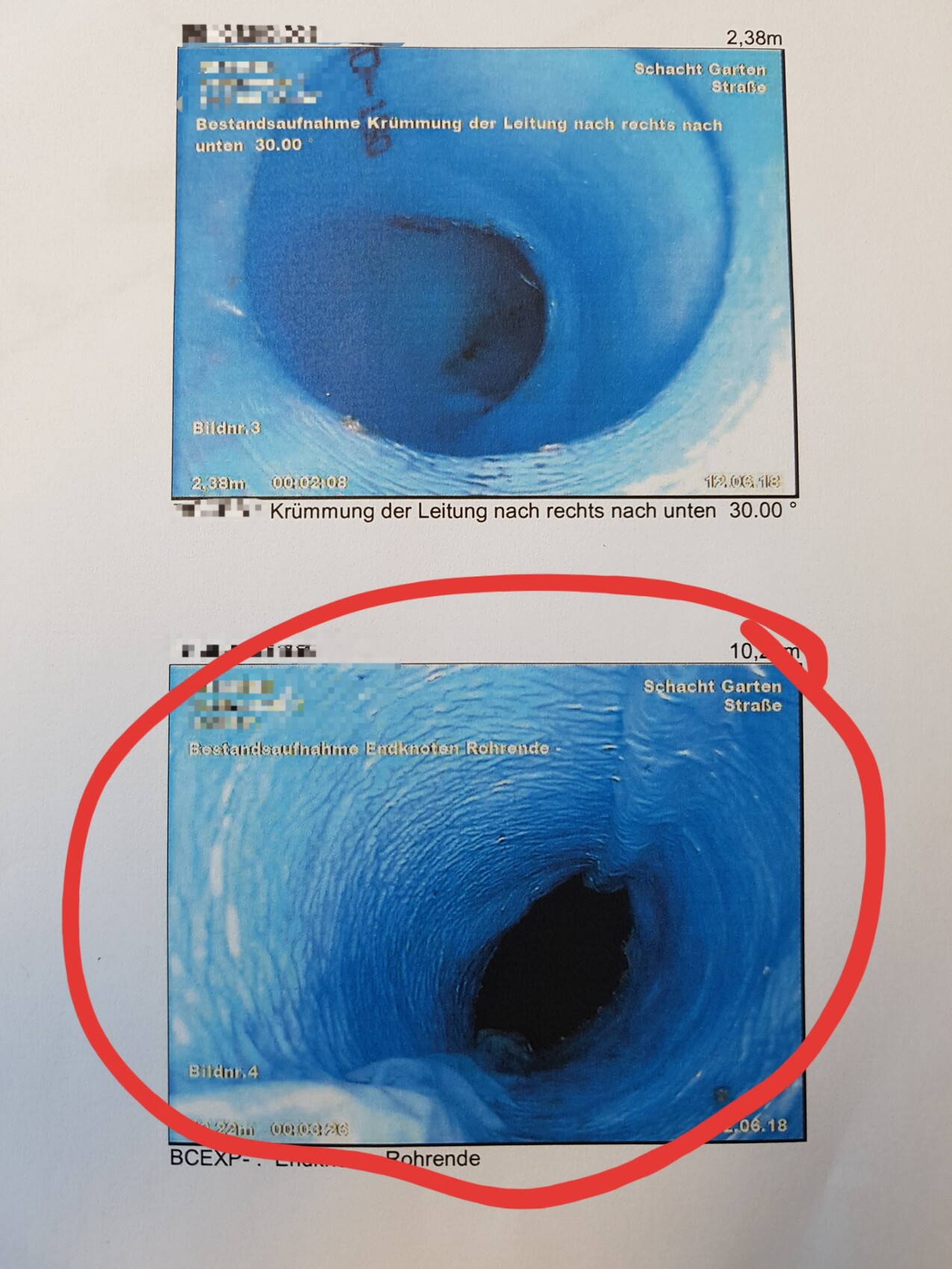

KlausMajoreHello, my old building renovation project is coming to an end, and finally, the drainage channel was repaired using a trenchless liner method.
In the final inspection report, it looks as shown in the attached picture.
This shouldn’t normally look like this, right? What do the experts here say about it?

Forenfux7827 Jun 2018 21:22At first glance, I would say the cross-section has been significantly narrowed. Maybe mill it out again and redo that spot? Were those several short liners, or one long inliner?
