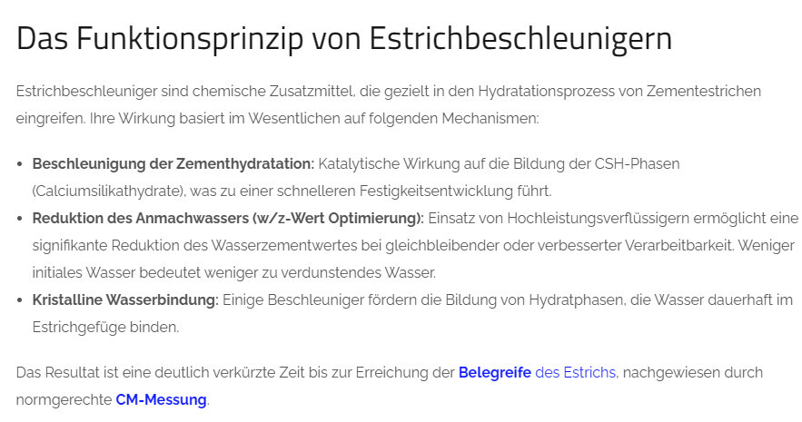

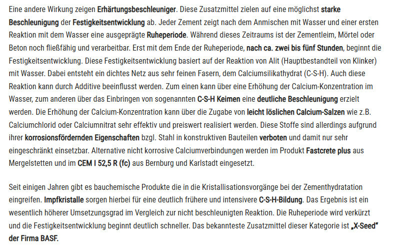

nordanney23 Jul 2025 09:20Tolentino schrieb:
Then either there are different types or my expert gave incorrect information. Incorrect. The mode of action is the same for all screed accelerators. You can verify this with manufacturers, installers, and even AI (LOL).
Or explained in more detail for professional users:
