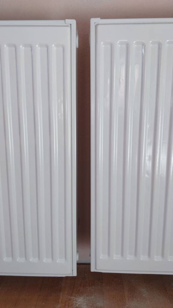

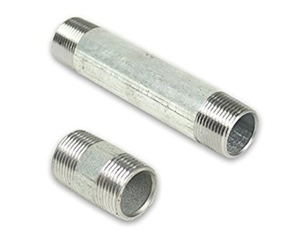

Can I connect these two identical radiators using the double nipple?

It is clear that the double nipple fits. My concern is about the functionality. Does the hot water flow from one to the next continuously?
tomtom7919 Apr 2018 21:35
The connector you showed won’t work because the thread on the other side will unscrew when you tighten it.

You need a flat-sealing screw connection; that will work.
And it will function properly.
