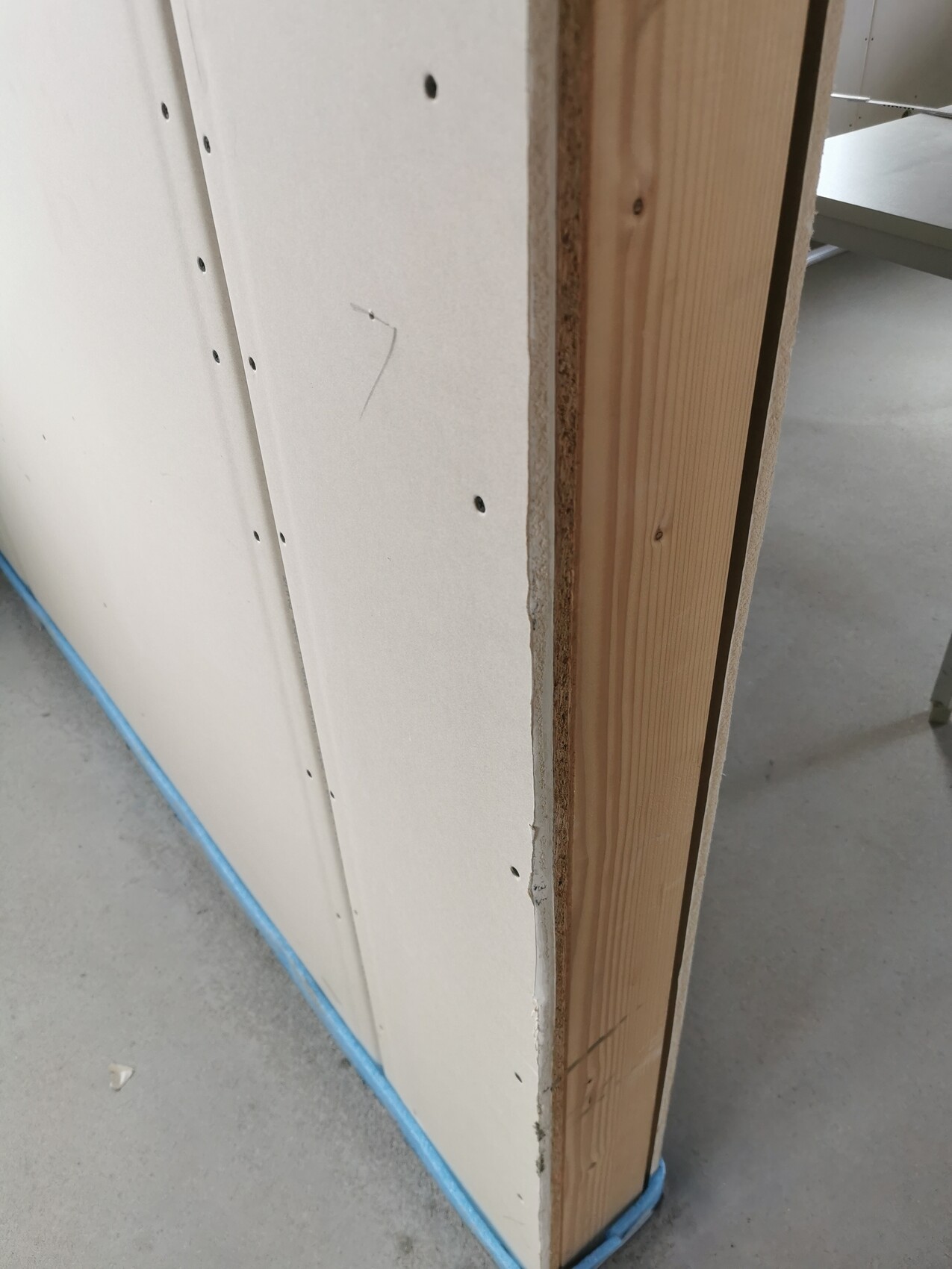

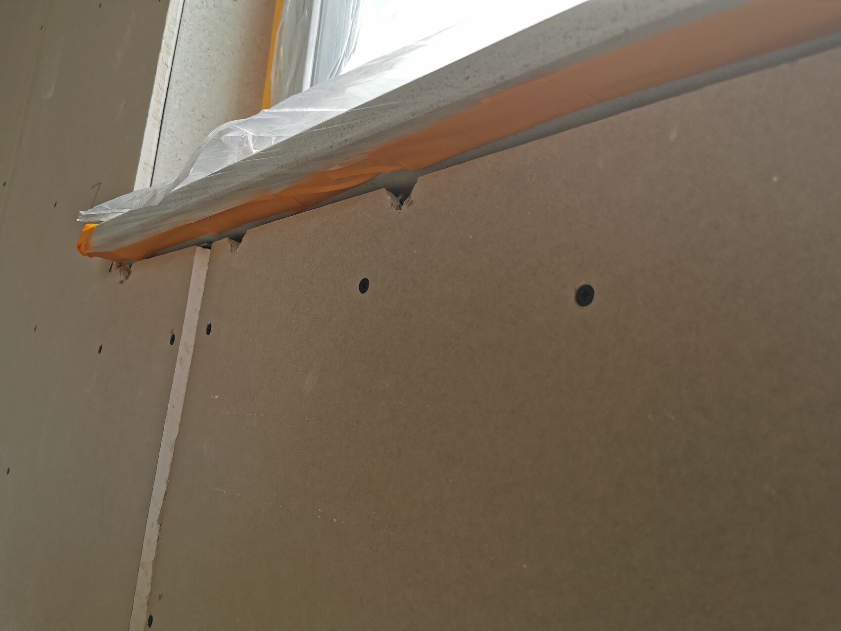

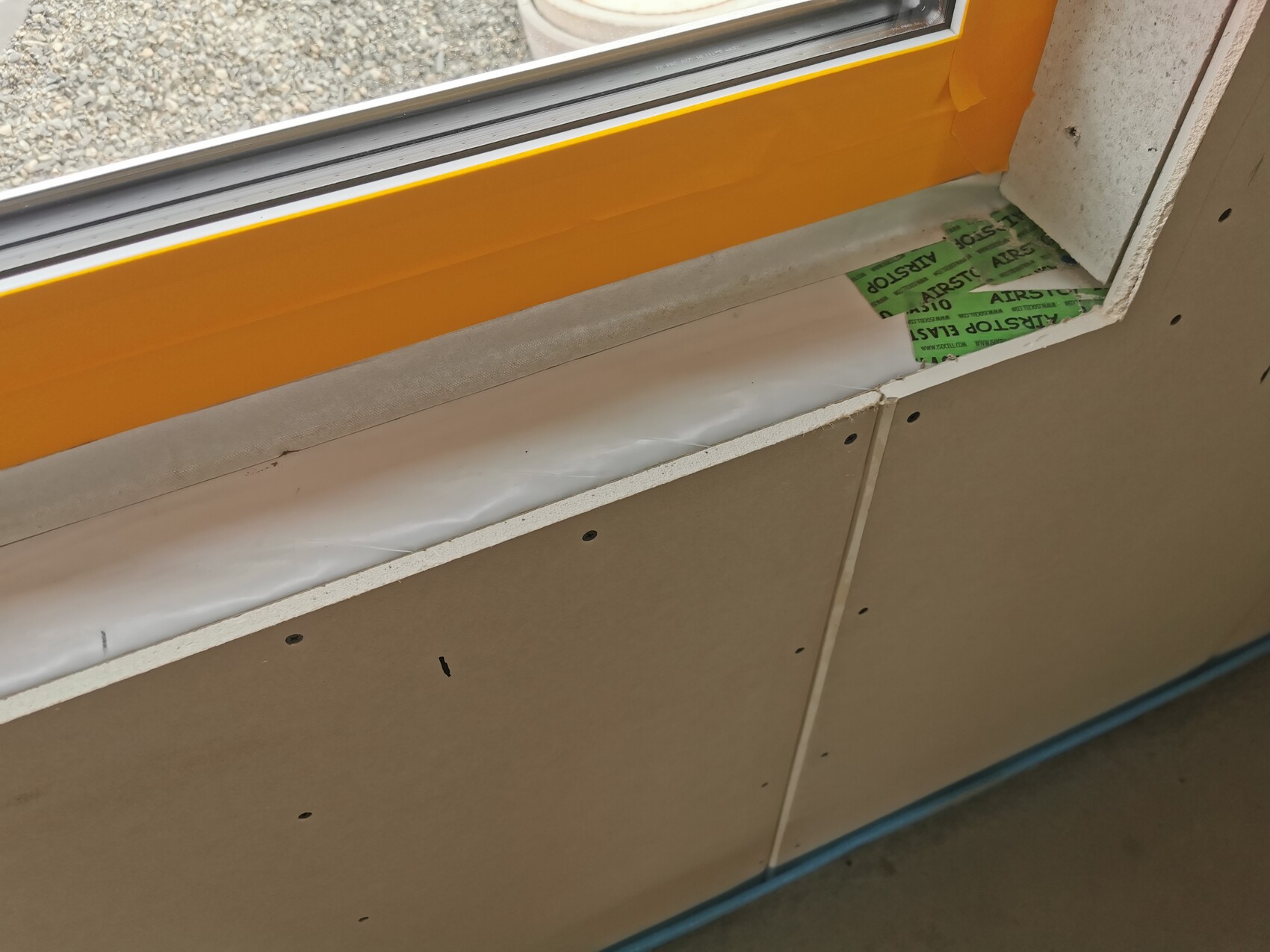

we are currently building a prefabricated house using timber frame construction and are about to start the drywall finishing and painting work. We are familiar with the theory so far. Aluminum corner protection strips will be installed on corners and window reveals.
Is edge protection also required on door reveals and under a windowsill or kitchen countertop? If so, which type is recommended?
Thank you 🙂
White drywall on timber studs, screw holes visible; blue protective film on the floor.
Window reveal with orange painter’s tape, green AIRSTOP sealing tape, and drywall panels.
Close-up of drywall panel with screws, top edge protected by film and orange tape.
11ant17 Sep 2024 15:33
The door reveals are framed by the door casings, and below the windowsill, I am more concerned about the offset of the panels.
Stephan—
18 Sep 2024 07:46
If no door frame or door is to be installed later in the door reveal, then yes.
If it is basically just used as a passageway (e.g., to a dressing room).
