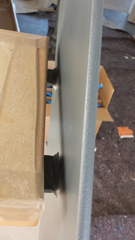

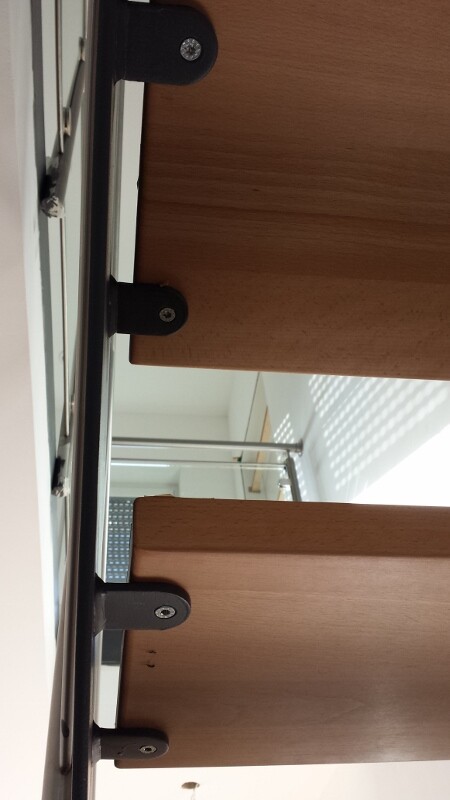

we had a steel stringer staircase installed and were satisfied until now. However, when the temporary steps were replaced with the final ones, there is now a 2 cm (0.8 inch) gap on each side.
It looks really bad, and everyone who has seen it so far agrees.
The stair builder says this is normal and actually makes cleaning easier. He also said that this complies with the DIN standard and that he doesn’t care if anyone dislikes it.
I couldn’t find any information online about a DIN standard regarding the gap between the (steel) stringer and the step.
Can someone tell me if there are any regulations about the maximum allowed gap size?
Thanks in advance!
Thanks in advance!
Bauexperte21 Mar 2014 22:53Good evening,
the DIN standard refers to the rise and going of the steps. Certainly not to the width of individual steps; the stair builder is talking nonsense.
Refuse acceptance "in writing" with reference to the sample according to the graphic and construction stages, and then have him come. For me, the steps are too narrow or the stringers are set too far apart.
