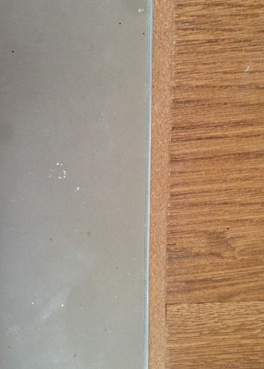

Müllerin schrieb:
There will be a baseboard at the transition anyway, right? Then 1-2mm shouldn’t be a problem... Actually, I wanted to use cork for the transition between the parquet and the tile, like in this picture I found online.
