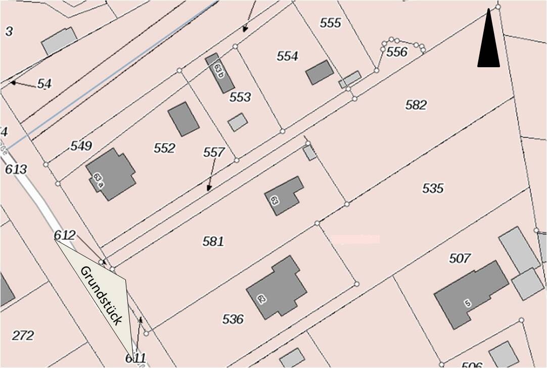

we have been following the forum for some time now and have developed our floor plan to a point where we would like to present it to the watchful and experienced eyes of this community.
A few words about the plot beforehand:
- Just under 1100 m² (approximately 18 m street frontage, just under 60 m deep) (about 11800 ft²; 59 ft street frontage, just under 197 ft deep)
- The plot is located at the end of a cul-de-sac and is therefore relatively quiet
- There is a stream nearby. Due to the high groundwater level, we will build without a basement
Plot size: 1070 m (11513 ft²)
Slope: no
Site occupancy index: 0.2
Floor area ratio: 0.3
Building window, building line and boundary: freely selectable, with setback areas
Edge development: all single-family houses, the adjacent plot (FS 582) will also be developed soon
Number of floors: 2
Roof type: hipped roof
Architectural style: modern urban villa
Orientation: at the northwest corner of the plot (approximately where the garden shed is currently marked)

- Oriented plot section (FS 581)
