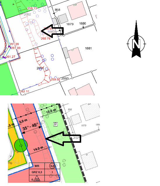

I have been silently following this forum for some time and would like to hear different opinions regarding a possible upcoming land purchase.
The image shows the site plan of a plot (top) and the relevant part of the development plan (bottom).
Red = buildable area,
Green = private green space where building is not allowed (protected area)
If I remember correctly, there are some trees on the east side – I will check more precisely this weekend or next week.
My own thoughts / remarks:
- The plot is about 800 m² (approximately 200 m² (2150 ft²) of which is green space), which is sufficiently large
- Very wide plot – flexible in terms of positioning
- The neighbor to the south is already developed and has a 6-meter (20 ft) double garage along “our” boundary line, so there is enough space between the houses
- The plot to the north is not yet sold – not sure what will be built on “our” side
When I try to mentally position the house, I reach some limitations
- Garden to the east: the sun shines on the side at midday – in the evening the house blocks the sun
- Garden / terrace next to the house (south side): if possible, then sun from three sides and sufficient distance from the neighbor thanks to their double garage – but would a fence be needed towards the street, or how is this usually handled?
- Where would the garage go? Possibly a double garage or carport as well
Thanks in advance
