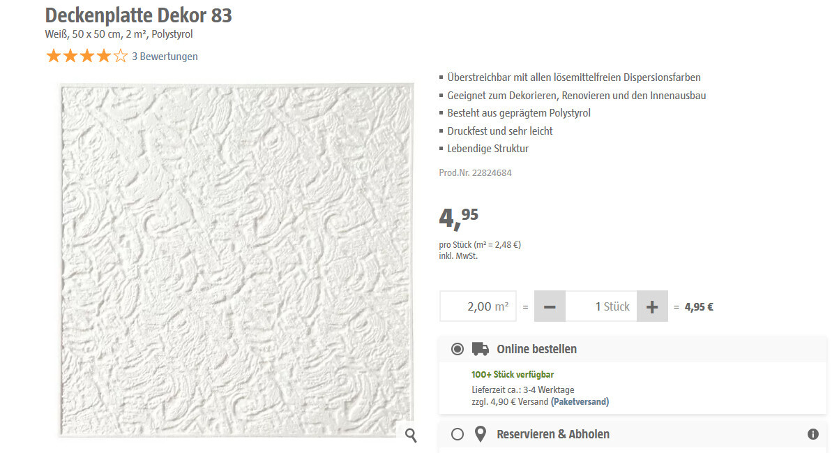

We are currently considering how to finish the reinforced concrete ceiling in our new build. Besides the usual non-woven wallpaper and/or painting, we have also thought about applying Styrofoam ceiling tiles. However, I wonder why this relatively simple method, compared to filling, sanding, wallpapering, and painting, is rarely seen in houses or apartments.
Are there any valid reasons for this? What are the advantages and disadvantages of such ceiling tiles?

Are there valid reasons for this? What are the pros and cons of using such ceiling panels? Reasons to use them? None.
Against them?
- Plastic on the ceiling
- Panels still need to be filled and either wallpapered or finished with a skim coat to achieve a smooth ceiling
- More expensive than directly applying the final surface treatment
- Plastic burns easily
Fifty years ago, these types of textured panels were commonly used. Something like this:
In an expensive new build, they have the appeal of… nothing. Each panel is clearly visible on its own.
