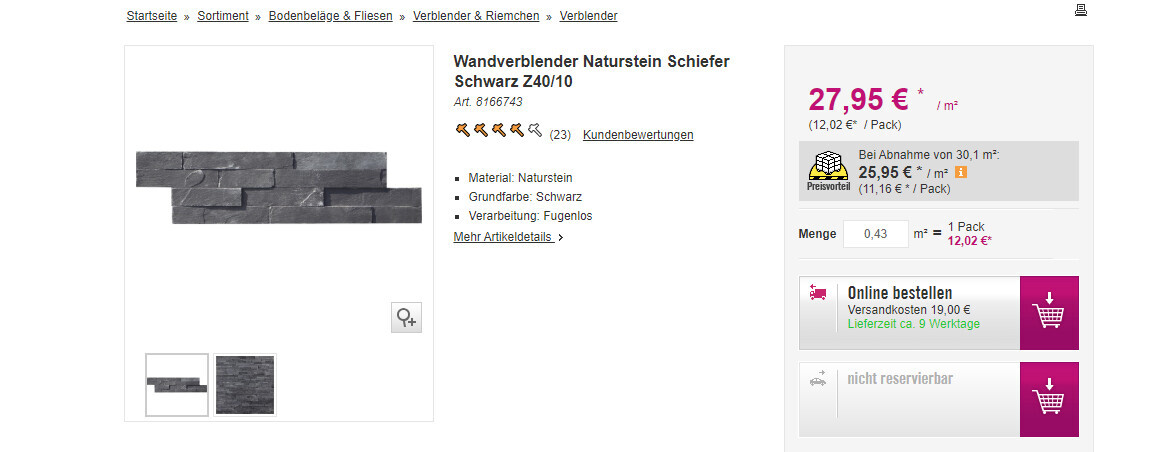

That was a standard slate wall cladding from the home improvement store. You can find it at any large DIY retailer, like Obi, etc. (around 30€/m² (3 USD/ft²)). Use a good flexible adhesive!
We have something similar: the same system, but with more colorful natural stone... I can’t even remember exactly which kind, but it’s quite well known and available in all the big stores.
Important: one type is 4 cm (1.6 inches) thick, the other only 2 cm (0.8 inches). So the thinner one is lighter.
It creates a very nice effect, better than flat 2D methods.
DerGuteTon16 Jul 2020 22:35nordanney schrieb:
This is how it looks, for example, with slate.That’s really a nice touch. I’m planning to decorate the wall behind my living room furniture, which is in black and white, with this after moving in. Should anything special be considered regarding the substrate? I’m thinking of applying it either directly onto a Q2 level plaster or having the painter, who will be there anyway, install at least a painter’s fleece wallpaper beforehand. He will do that on the other walls anyway, and it might be a good idea for a potential period after the slate tiles are installed.
