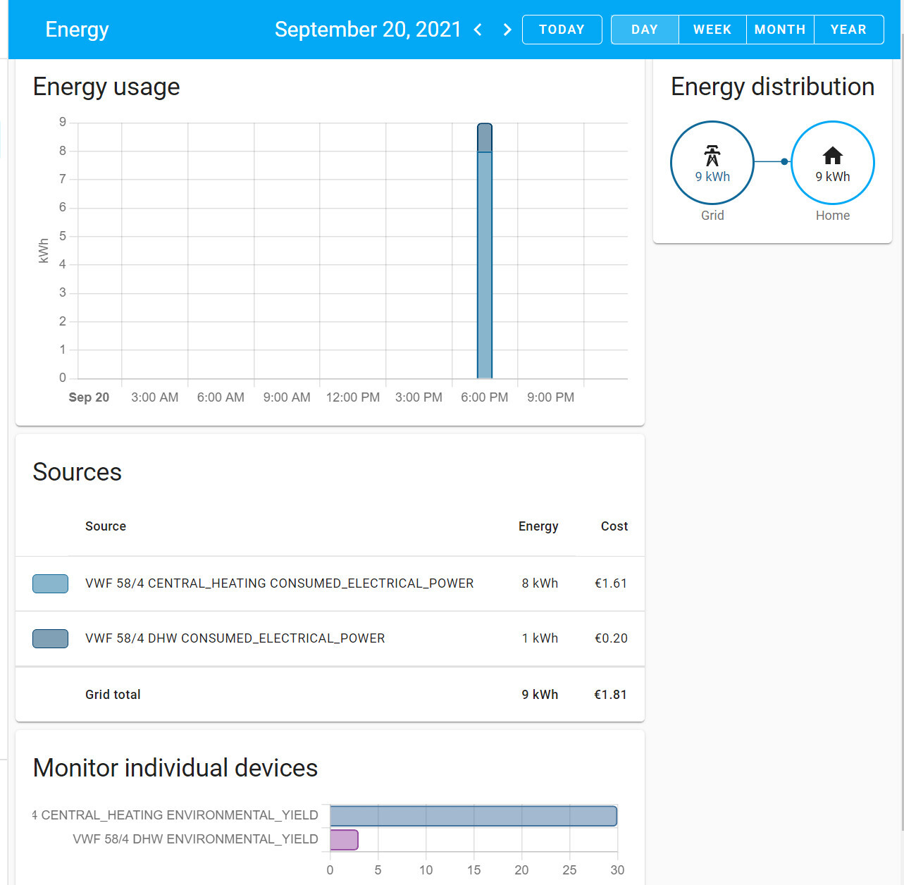

and also have a VR700/VR921 Internet Module installed. This allows integration of the air-to-water heat pump and controlled ventilation system into the home automation.
@micric3
Is the module intended only for home automation or mobile control, or is it also required for connecting to the photovoltaic system or for communication between the devices? Do you happen to know more about this?
