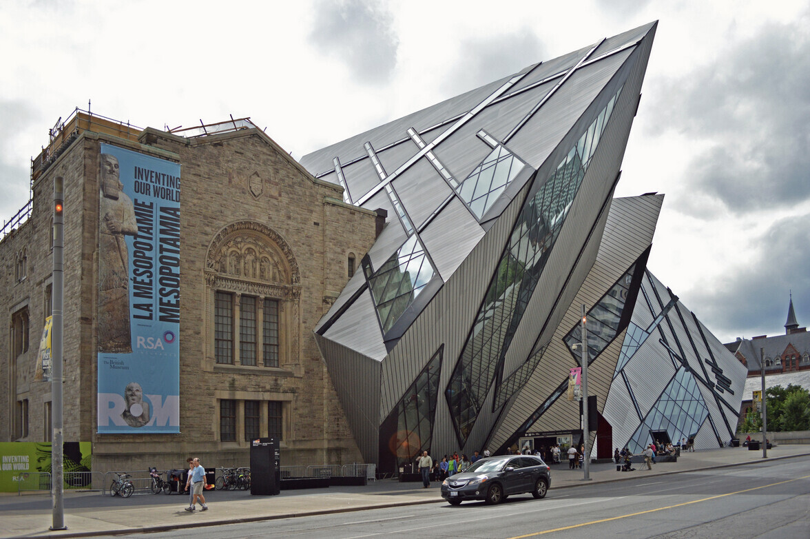

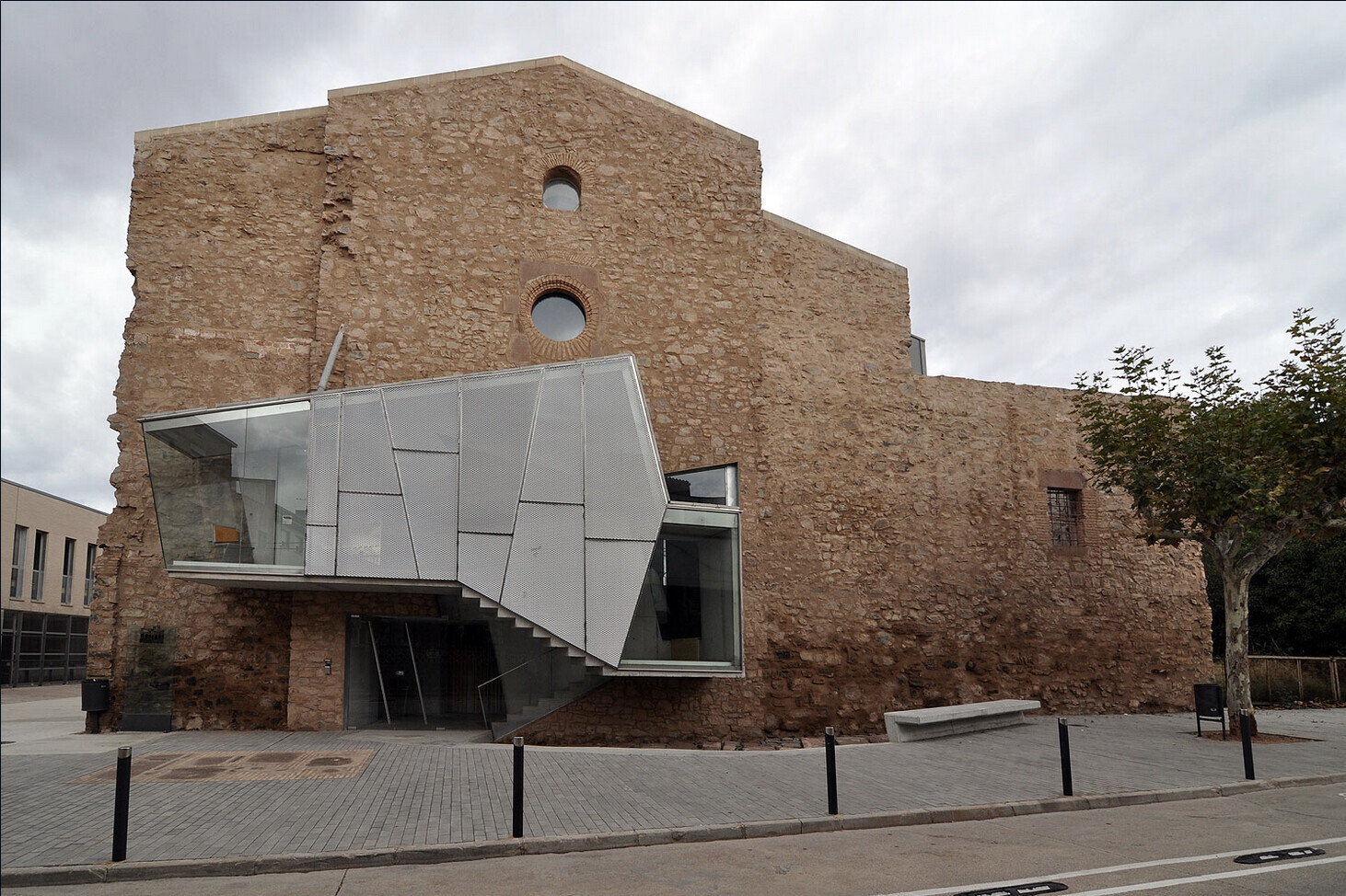

ateliersiegel3 Jul 2023 00:15
In architecture, this is almost a "style" in itself. You don’t have to like it, but it is not really uncommon.
Modern curved glass building next to historic pastel-colored facades in Prague.
Modern pointed glass/metal facade next to historic stone facade of the ROM Museum.
Historic stone building with modern metal-glass facade and staircase.

WilderSueden
3 Jul 2023 08:50
Your examples from #19 are out of place. And no, that does not create a deliberate contrast; it just comes across as awkwardly different.
