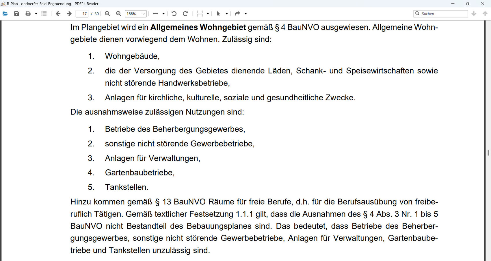

It is stated in the zoning plan, although the link has since been removed. Here is the relevant excerpt (I hadn’t read everything beforehand).
Unfortunately, I cannot copy and paste because the PDF is protected (and I’m currently not in the mood to bypass the protection).
This is the zoning plan of the municipality of Rabenau, district of Geilshausen. Residential area "Im Löndörfer Feld."
So, it is actually permitted, but specifically not allowed here (definitely not).

rulor1992 schrieb:
Permitted uses are: 1. residential buildings, 2. shops serving the area, pubs and restaurants, as well as non-disruptive craft businesses, 3. facilities for religious, cultural, social, and health purposes. The occasionally permitted uses are: 1. accommodation businesses, 2. other non-disruptive commercial enterprises, 3. administrative facilities, 4. horticultural businesses, 5. gas stations“other non-disruptive commercial enterprises”: To me, that sounds very vague. But maybe it’s a standard wording meant to keep noisy industry away. Many people consider trucks disruptive. Families with children definitely want to live there.What kind of trucks are we talking about here? More like 7.5 tons (8 tons) or 40 tons (44 tons)?
Basically, there’s only one option: schedule an appointment with the city authorities, present your plans, and ask if this is acceptable.
Skimming through also indicates a mixed-use area?!
Accordingly, commercial use could of course be possible.
