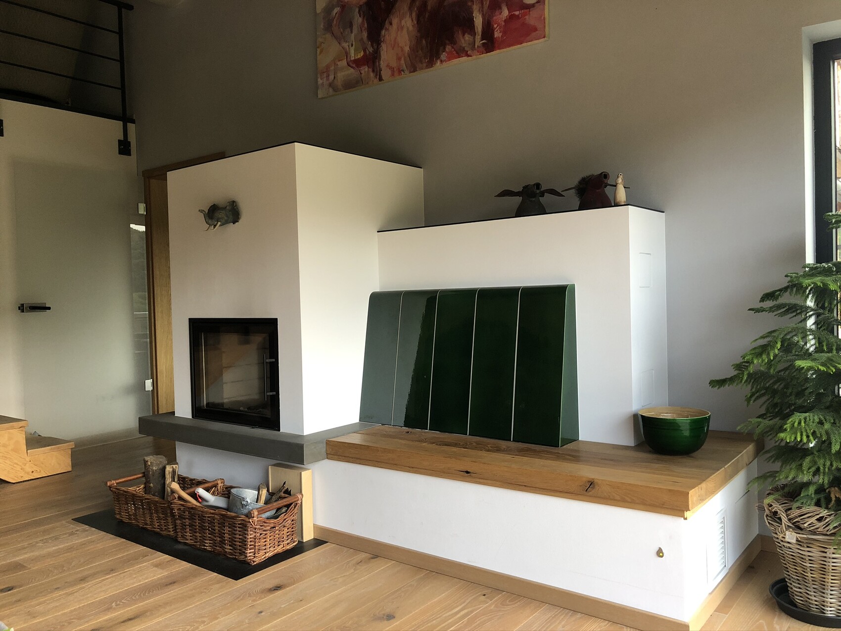

hampshire10 Nov 2020 22:55Exactly, the storage mass ensures that the heat output is spread over a longer period. Build a masonry heater with a long flue path and substantial storage mass. We had the stove built by Ortner because we were convinced by their air supply system and the simple, effective combustion control. We then discussed the design with the stove builder. Although our stove does not share heat between rooms, that is of course also possible.
The issue I see with this is the three-sided glass (see image).
So far, I haven’t found a good solution online for a panoramic fireplace with thermal storage elements.

Alessandro18 Nov 2020 10:50Hi @Abellio
I have a SCHMID 9kW stove used as a room divider. It also has quite a lot of thermal mass, including masonry built up to ceiling height.
We typically fuel it with about 3kg (6.6 pounds) of wood.
Our sofa is quite close to the stove, but we still enjoy comfortable temperatures.
Does the photo above show your house?
@hampshire: great fireplace!
I recommend getting an ash vacuum cleaner. Definitely worth it 🙂
