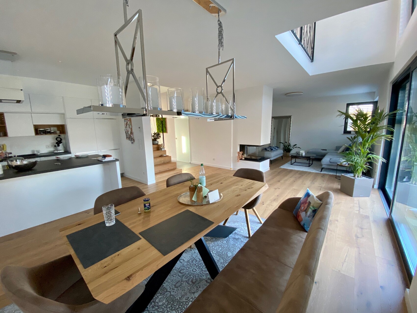

I have a SCHMID 9kW stove as a room divider. It also has quite a lot of thermal mass. Among other things, I had it built up to ceiling height.
We usually fuel it with about 3kg (6.6 lbs) of wood.
Our couch is quite close, but we still enjoy comfortable temperatures.
Does your picture above show your house?
@hampshire : great fireplace!

Hi Alessandro,
Thank you very much for your input and experience.
What is the exact model of your Schmid stove?
It looks good in terms of size.
PS The picture is not from our house, but we have the stove positioned similarly to you as a room divider.

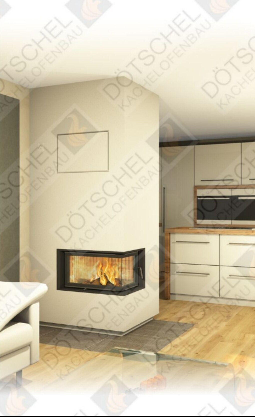

We originally wanted a panoramic fireplace as a room divider. However, our stove fitter strongly advised against it, as too much heat would be released uncontrollably into the room through the three glass panels.
We have now decided on a corner fireplace (HKD 11) from Brunner (which still has 11 kW) and built it up to the ceiling, incorporating as much thermal mass as possible.
Ps: Sorry for the duplicate image; uploading and especially deleting images in this forum doesn’t work properly with my phone.
Open living kitchen with fireplace wall and wooden countertop.
Modern living area with stove built into a wall, open kitchen with wooden countertop.

Is the 11kW rating for the unit alone or the entire system? The power rating for stoves refers to a specific time period. As the thermal storage mass increases, the required power rating of the system decreases, since the heat energy is released at a time beyond the measurement period.
