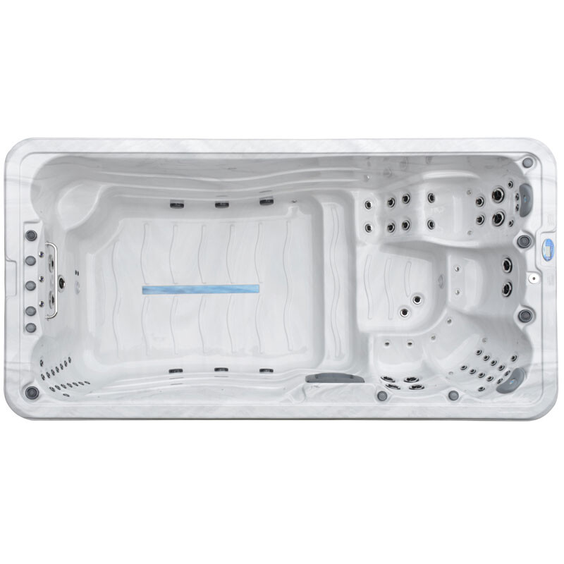

Grolsch3022 Aug 2020 16:33We also considered building a pool, but we will most likely opt for a swim spa.
A swim spa has different uses and requirements. The higher the water temperature, the more advanced the technology should be. Cartridge filters require a lot of maintenance. It is better to use a large sand filter system along with automatic measurement and dosing of pH and sanitizers (chlorine, bromine, ozone, saltwater electrolysis...).
Insulation and covers should also be of high quality, as otherwise, energy loss can be extreme.
With 1.16 kW, you can heat 1 m³ (35 cubic feet) of water by 1 degree. During the night, it is common to lose 2–3 degrees. Let’s consider a 70 m³ (2,470 cubic feet) pool. That means 140–210 kW are needed just to compensate for heat loss overnight...
If space allows, solar collectors can be an economical option. Otherwise, a heat pump or connection to the house’s central heating system can be used.

@Mycraft,
I live in an area full of pools and am surrounded by them. From my 20 years of experience in this environment, pools are mainly used extensively only when there are several children in the household. Adults rarely use the pool, except for one person who uses it regularly, but he also frequents nudist beaches. The sea is about 1 meter (0.6 miles) from my house.
There are many reasons why pools are not used more often. People don’t feel like swimming every day, there are other tasks inside and around the house, shift work, visitors, and so on. It’s like boats here. They rarely see water, even though the boat ramp is just around the corner. Usually, no one in the family wants to participate, plus there are the costs.
We have a swim spa, Oasis Platinum 4.4 x 2.25 meters (14.4 x 7.4 feet), and I use it five times a week. We have a heat pump and solar panels; otherwise, the electricity costs would be quite high. In winter, I keep it at 36°C (97°F). Winter here means no less than 5°C (41°F) at night and 15°C (59°F) during the day. It’s really something for adults.
Safety regarding pools and spas is taken very seriously here. Even though our spa is 1.3 meters (4.3 feet) high and has heavy covers that I can’t lift, it still has to be fenced off, 80 centimeters (31 inches) from the neighbor’s fence (which is 1.8 meters (6 feet) high and opaque), and many other regulations.

Better to have a large sand filter system and automatic measurement and dosing of pH and sanitation chemicals (chlorine, bromine, ozone, saltwater electrolysis…nobody does that hereOh cool, I just checked those out, that could be something for me too. We bought a house with an existing pool. It’s nice, especially since we want to have children and it’s obviously great for them. I barely used the pool for swimming or splashing around last year; I mostly just floated on an air mattress. A hot tub attached definitely has its appeal. We just aren’t too fond of the plastic look.

@swimspa: we actively decided against it. We don’t like the look, and I want to have different temperatures for whirlpool and swimming (significantly different).
